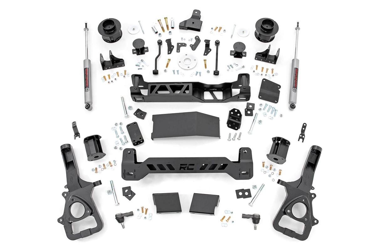

Here’s the deal, that is not sustainable. The angle this places on the upper control arm ball joint AND axle joint will likely cause damage. I do not drive around (other than tight parking spots) this high, and I have not put it in 4WD at all at this height.
Those issues are all addressed when a lift is installed, by dropping the front diff and changing the knuckle or upper control arm.
