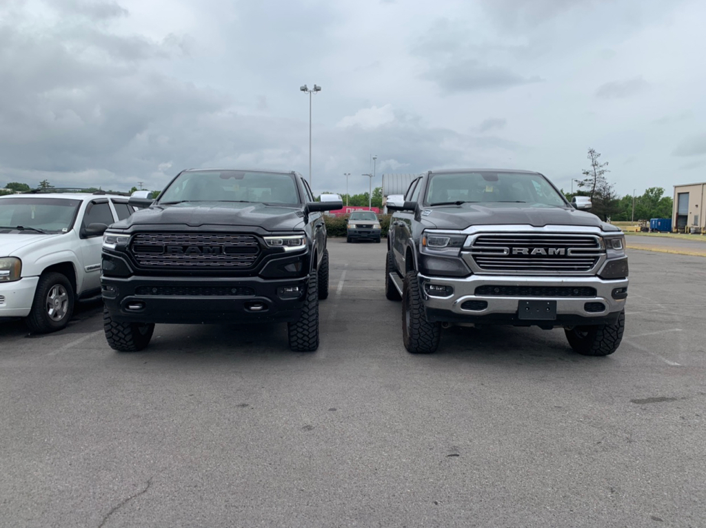

Most common response on here is 5 “disconnects” before recharge is required.
I don’t have documentation to prove, but I do know that I disconnected both fronts the first time I tried to install the spacers, then couldn’t get the upper ball joint to separate, so I put it back together. The next attempt was to just unbolt the upper control arm to get room to remove front struts. That worked like a charm.
So I have disconnected both front struts twice, and have full functionality and comfort from mine. Also-homemade links to adjust height after spacer install.
This is in OR1, parked next to 6” lift.
OR2 is unavailable since I have maxed out OR1 ride quality and lift.
(Disclaimer-I don’t usually ride around in OR1, even though it isn’t TOO bouncy, but that’s only to protect my CV joints and Ball joints)
Which is which? So, at max height, the leveling kit on an air ride truck is basically just as tall as a 6" lift? Both of these trucks look great. Maybe this is what I'll do to my Rebel.
Nucdancer01
Apr 13, 2019
29
35
Not quite same, but a spacer and links adjusted for max height will get you close.
Here’s the deal, that is not sustainable. The angle this places on the upper control arm ball joint AND axle joint will likely cause damage. I do not drive around (other than tight parking spots) this high, and I have not put it in 4WD at all at this height.
Those issues are all addressed when a lift is installed, by dropping the front diff and changing the knuckle or upper control arm.
Mine is the black one (limited-hence air suspension)
