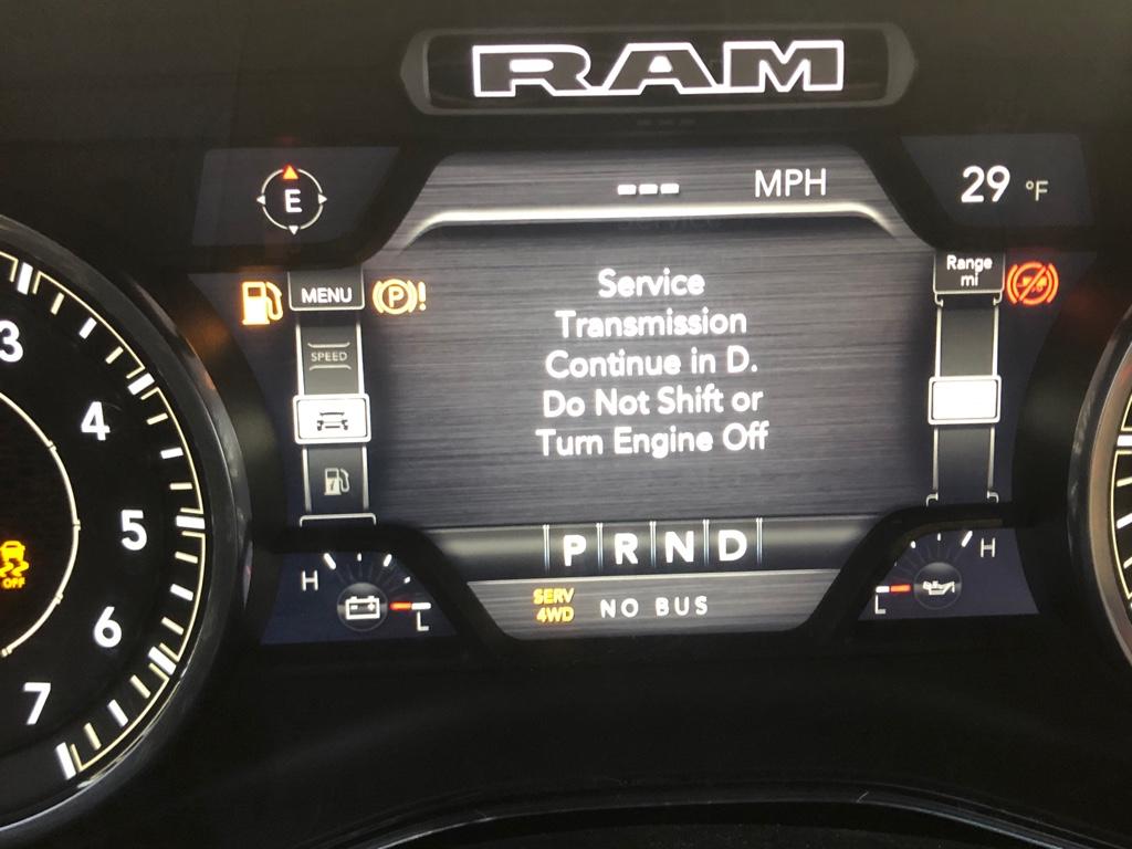

I have a 2022 ram 2500 diesel bighorn and looking to upgrade to the 7” cluster, I found a cluster for a 2020 1500 eco diesel limited, it looks the same as a cluster for a 2500 diesel other the. The rpm redline is alittle higher, hopfully it works 🤞has anybody done this? Wounder if I am gonna have to reprogram it
Well a 1500 cluster will not work in 2500
