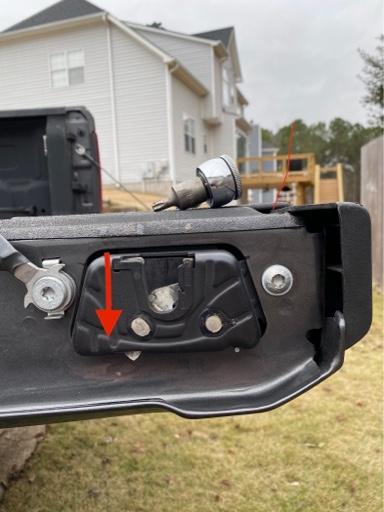

I’ve posted about this quite a few times. Get a T45 torx bit and a ratchet, loosen (not remove) the passenger side striker bolt (where the TG latches) and move it rearwards about 1/16 to 1/8 inch and tighten back down. Mine did this when I purchased a year ago, spent 30 seconds doing the procedure above, and have not had another problem in over a year.
+1 on this.
In my case, the drivers side needed adjusting. When lightly closing (not slamming) the TG, I could tell the drivers side was the tighter of the two-it latched first.
I made marks to mark the original position and loosened it to move it in the direction of the arrow a very small amount-about the thickness of my mark, and retightened. Literally 30 seconds to fix. If you don’t have enough travel on one side, I think you could adjust the other side in the opposite direction as well, so that they close evenly.
