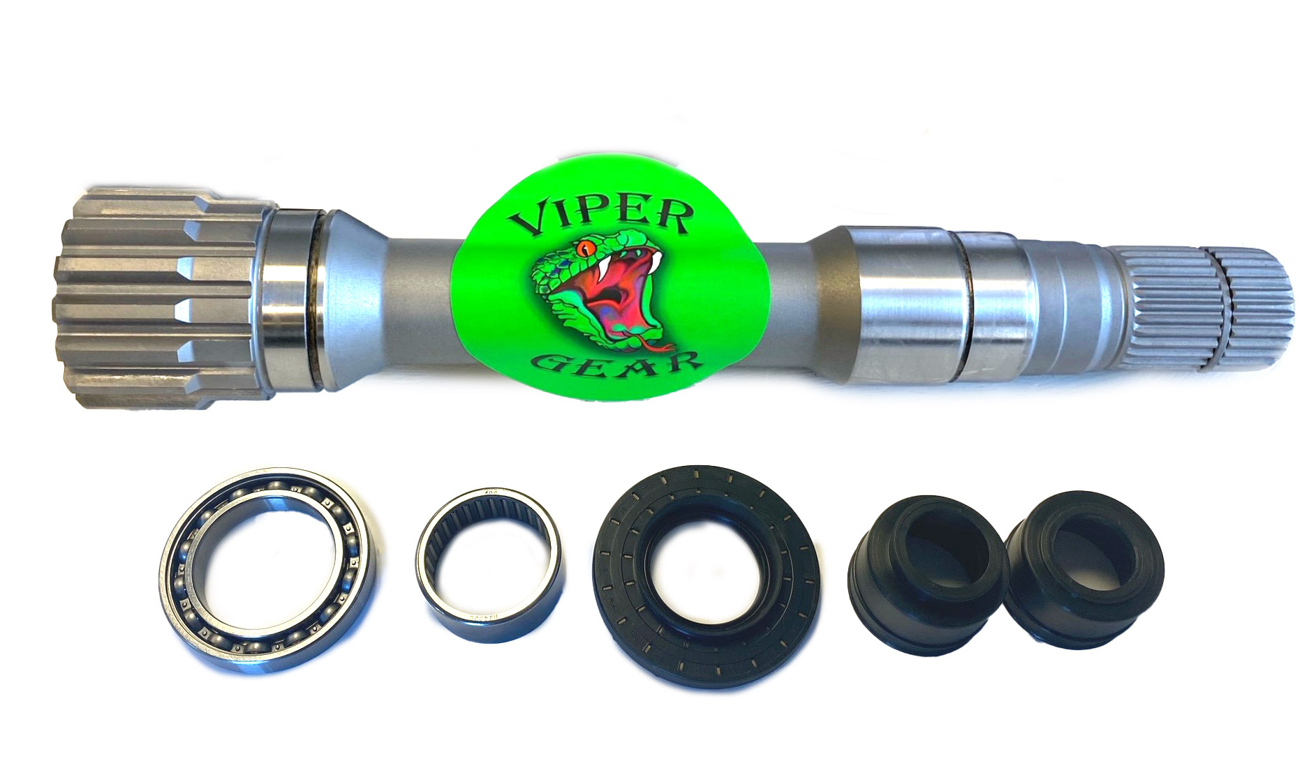

Unfortunately yes.. it's a non greased, non sealed spline between the differential output shaft and the CV-axle. They wear out.. mine is just about gone at 64k miles.
Planning on buying the Dorman replacement kit and not sure what brand CV Axle, instead of the whole assembly from RAM, and doing it myself. Probably be less than $700 in parts.
