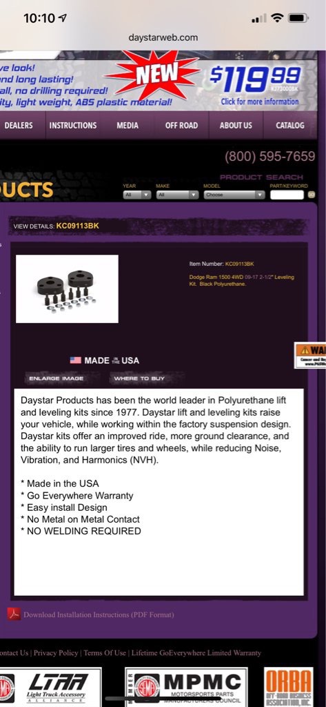

OU Scott, did you remove the leveling links after adding the DayStar kit? I installed the Revel links (front only) and while the ride was certainly affected, not as severely as you reported. Thanks for all the information, there is very little available about the AirRide set up on the new 2019 models and several dealers and custom shops were useless. I am looking at the Terra Grappler G2 in the 35x11.50x20 size. Test fitted a 12.50 in another brand and it rubbed on the suspension at wheel lock.
You have to keep the adjustable links in. All though adding the spacer gives lift potential the air system would notice the height change and bring it back down. Level links correct this and spacer allows for more stock like psi in your air suspension (less stiff).
After driving for a week without the Daystar, and now the past couple weeks with it in, I'm very glad I went the extra step.
I also added some side steps a week ago. Definitely nice having a lift available at work! Jelly?

Has anyone installed the Daystar spacer on a Limited with air suspension AND off-road package? The off road package has a 1" lift and different shocks from regular trucks and rebel.
Link to other thread post.
What is the total length center to center of the links? I bought some ends @ granger and m5 stainless thread rod and did the 2.25” center holes and or2 throws code. Putting daystar on tomorrow.
I think I ended up somewhere around 65mm if I remember right. I tweaked a little on the passenger side to even out. I never remeasured after that...
Also, on the Rebel we have E/E, Aero, Normal and OR, I think essentially we ride in OR1 as normal. Not sure if that makes a difference between trim levels when leveling with links.
