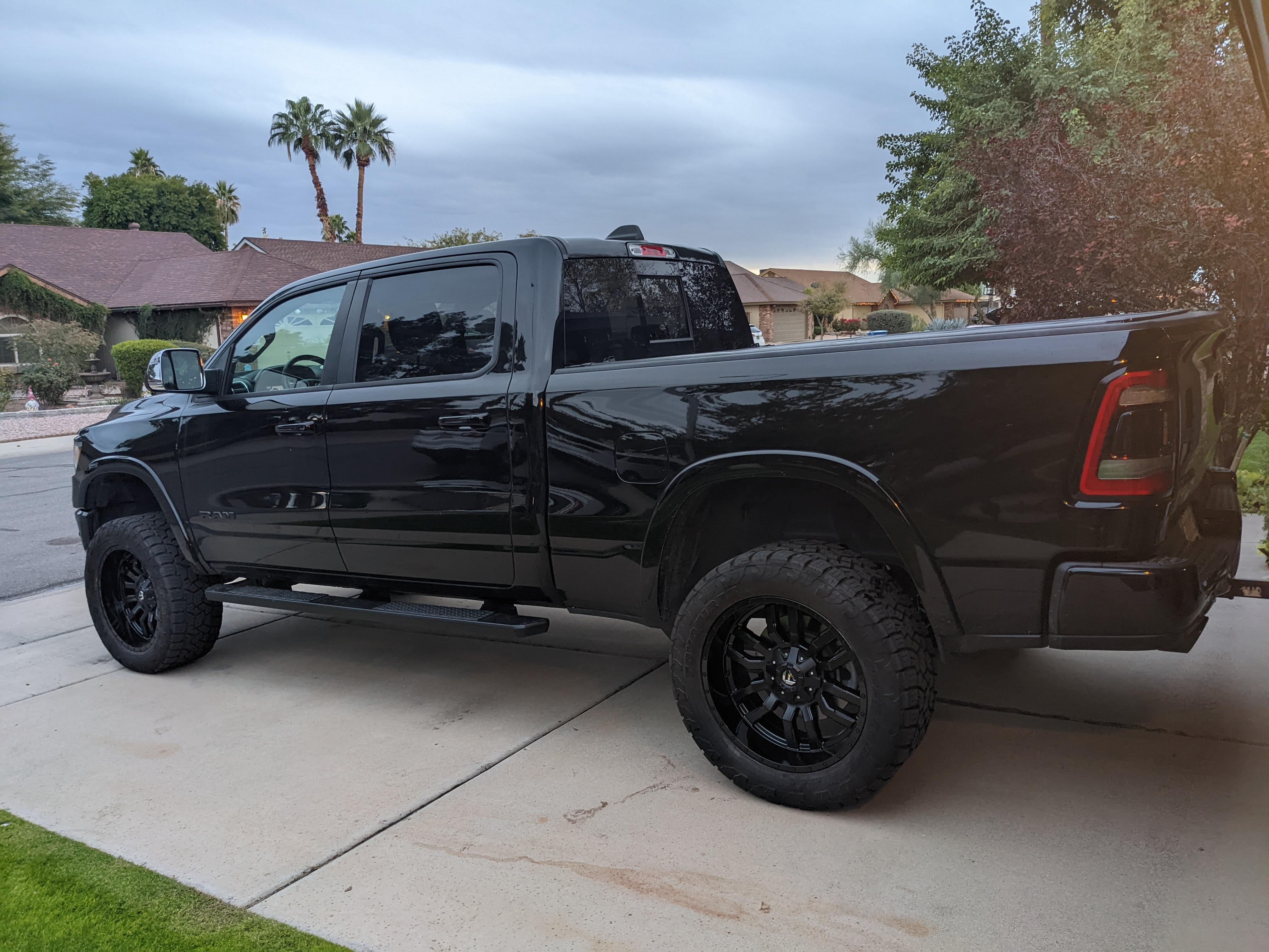

I did add quite aggressive tires, but I had to lift it.
Toyo Open Country AT 3
325/50/22
