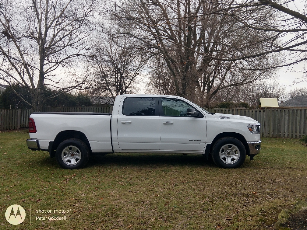

18" Tradesman steel wheels , bought when I purchased my truck , Winter tires The law in Quebec Canada .
Sent from my moto x4 using Tapatalk

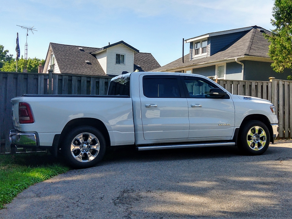

20" Summer wheels .
