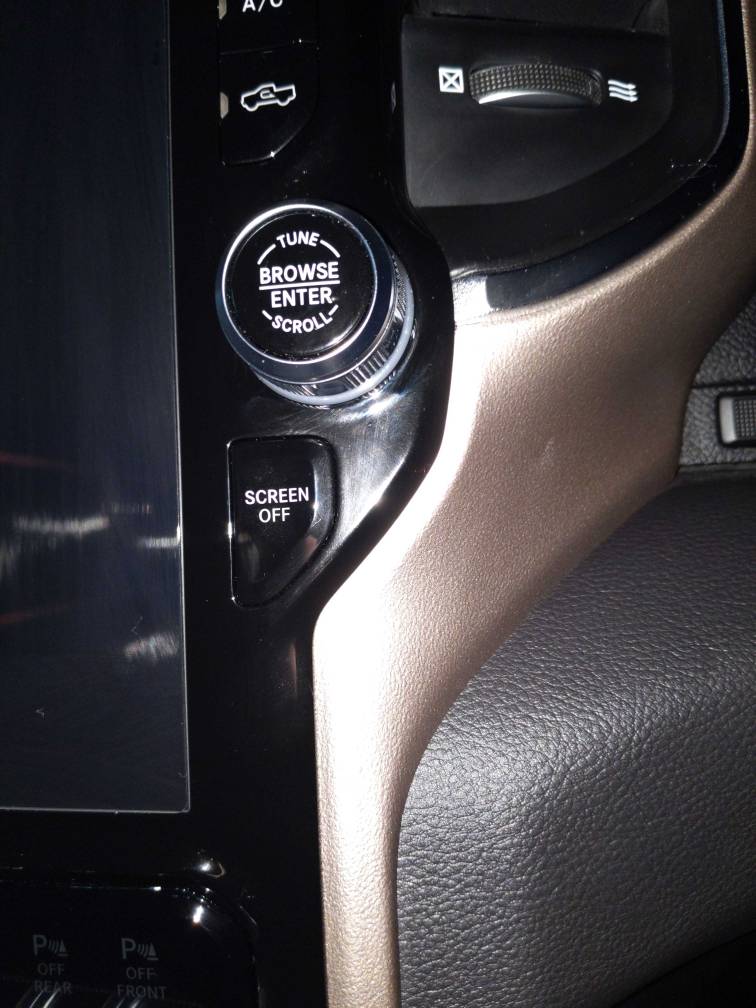

I have 5th gen ram with 12 inch screen. Batterie died, got it jumped off. Now screen won't come on and the ac is not working. Like the whole dashboard is dead. Except speedometer screen. Blown fuse? Thanks.
Silly question, but did you try the Screen Off button?
Ok, sometimes it's the simple things that get overlooked. Hopefully you didn't fry something when you jumped it off. Good luck!
