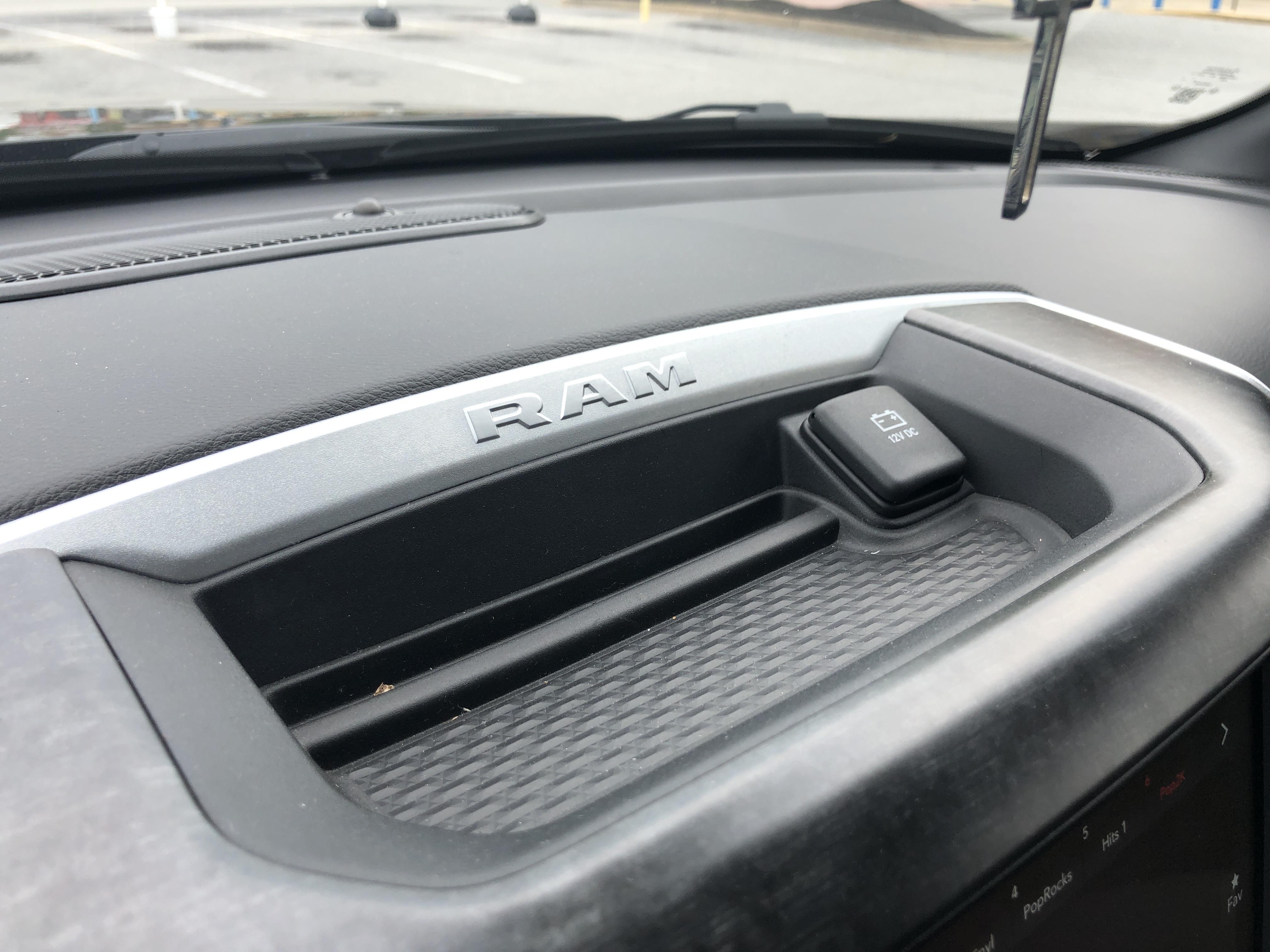

Yeah what Eighty said! Should have one above radio. I thought the same thing. Until I tossed my sunglasses up there and noticed it lol.
Remember, the center stack 12V only works with "key" on. U would have to go to yer interior fuse box and change setting on fuse to have the socket have power all the time.
OK: caveat: on MY 19, my center stack is fused "ignition only". U have to look at the socket cover and see if it has a "Key" symbol or a "Battery" symbol. It depends upon which symbol stamped on that lil cover on whether the outlet is active all the time or key only. On MY 19, it is key only, but I see the pic of the center stack on MurphBig horn truck (post # 7) and his shows battery, and his info shows a 2021 truck.
