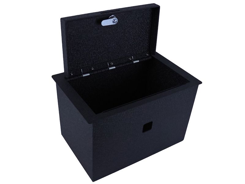

Hi all - recently purchased a 2022 Ram 1500 Limited. I would never have imagined a truck would be as (if not more) comfortable than our outgoing Volvo XC90, but wow this rig as awesome. Anyway, looking for input on installing a console safe - suggestions on what fits well (or doesn't) and what is overkill. Seems like the sky is limit when it comes to cost, but I'm looking for something that works - without being a flimsy POS. Really just something to ensure no access to my pistol if the kids are playing in the car or if I park it at the airport. Thanks all!

I have the factory installed Mopar one in my Built to Serve. I don't really use it, but it works, and you know it will fit. Just a basic key lock, nothing fancy. I might us it more if it was a combo lock, as I don't have a keyring I carry with me

Do you have the center console or a jump seat? I'm not sure if the jump seat is an option on the Limited.
I have a 2021 Limited with the center console and went with the Tuffy Console safe through Amazon. It is pretty solid and feels like it wouldn't be easy to pry into. It takes up the rear of the console but is low enough the sliding cup holder goes over the top, as long as you don't leave the key in the lock. Tuffy Console Safe on Amazon
I usually have a large water bottle in the front of the console that I have to move in order to slide the cup holder all the way forward to get into the safe. Since I only use it to store the pistol when I'm can't carry it on me I'm ok with the bit of inconvenience.

I believe there is one that doesn't require cutting the tabs out down below, but can't remember the name or where I seen it.
Look at Console Vault.
I believe Locker Down require cutting parts out.

Locker Down makes a version for the Limited and Longhorn which require no cutting of anything. They also offer different types of locking mechanisms.

I recently installed this from @Realtruck
It fits great and is ample size for my PDP compact and spare mag. Combo lock it awesome so I don’t need a key. No cutting or modification needed. Drops right in.

I'd have some concerns with that one if it's going into a Limited or Longhorn. There is less clearance under the sliding portion in a Limited and Longhorn center console, and it's likely that this safe is too tall for the OP's Limited.
Nice catch. I didn’t think about that.

I will also say that the factory Mopar one is pretty good. It's manufactured by Tuffy and fits pretty seamlessly with the Rams console. Plenty of space for a full size pistol (Beretta 92), spare mags, and a box of cartridges, with room to spare. My Sig 365 could swim in the thing.

The Mopar one is also made to fit in the Big Horn center console. I suspect it will cause issues with the sliding tray if the OP installs one in his Limited.

I thought the consoles were more or less the same. Mine also has the sliding tray and it works no problem with the safe. If the limited is significantly different then yes, there maybe issues.
Edit:
Did some quick research, and yes, the clearances are different in the limited. I stand corrected!

I have the Mopar one in my Laramie. I lock my pistol and extra magazines in it and it works well with plenty of room.
I don't how different the Limited console is, so not sure if the Laramie safe fits both.
