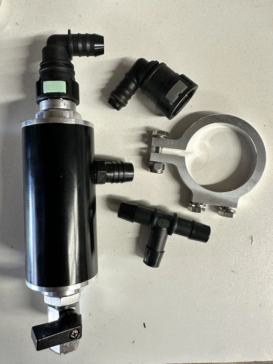

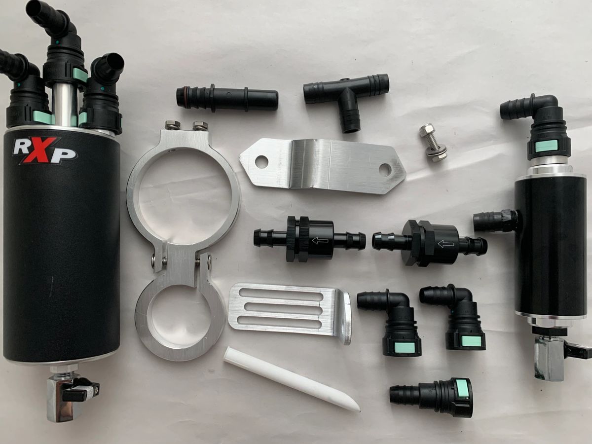

For these trucks since we only need 1 input and output you could just get the mini can from these guys (100% American made)
I have my older bigger one so I use a T tap with check valves
This is the setup I used before
