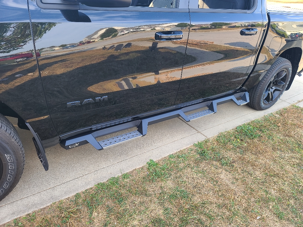

The only thing I do not like about the Westin HDX is the label is riveted on, seems like a logical place to rust at the rivet..if the plate is steel that is
Mine are made of stainless steel, but I paid extra for that version.

How has the HDX stainless version held up? I’m interested in getting them soon and want to see how they’ve come out?
3 years and they are still looking great. No issues with winter salt.
That’s great to hear! And appreciate you responding :). They’re a good $200 more but sounds like it’s worth it. I’m in Colorado and we get snow but no salt. Did you line-x or treat it any way or just kept them as they came?
No, I just installed them as they are. I thought about putting some Line-X or something like that on the actual silver steps but I never did that. They do remove with a couple of screws and then you can coat them or whatever. But they've held up really well.
