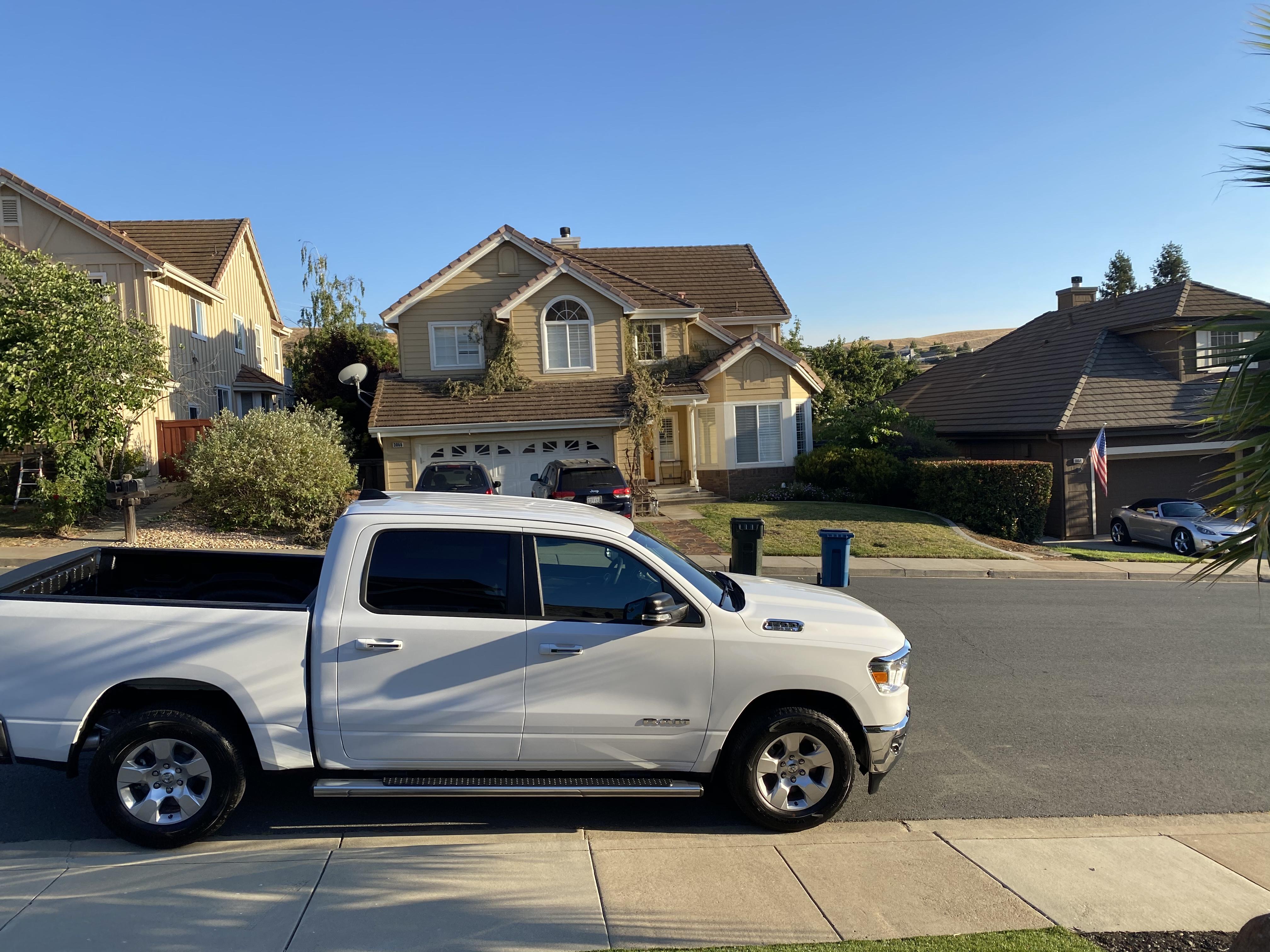

Had the windows tinted on my truck.
3M Crystalline 70% - front windshield and front side windows
3M Ceramic IR 35% - rear side windows and rear windshield.
Surprisingly, the rear windows metered at 9.7% after applying 3M Ceramic IR 35%. The spec sheet shows this film to have a VLT of 45% despite being called a 35% film. Glad I did not go any darker.
I am also a bit surprised by how dark the front side windows and front windshield appear with Crystalline 70%. The first two photos were taken in indirect light at 6pm while the 3rd picture was taken in very strong sunlight. I think posts saying that 70% film is unnoticeable is definitely not true. Perhaps the weird hue and color of 3M Crystalline is also causing the glass to appear darker?
Regardless I am very happy with the heat rejection and the overall appearance of the truck. The truck stays incredibly cool even after being parked outside all day.

The rear windows come from the factory with 20% and I know the front are tinted too but I'm not sure the %.
I'm not sure if there is any specific equation to calculate final tint when you layer it but if you have 20% of something to start with (e.g. light penetration) then 35% of that would be 7%. That's not too far off from the ~10% you have.

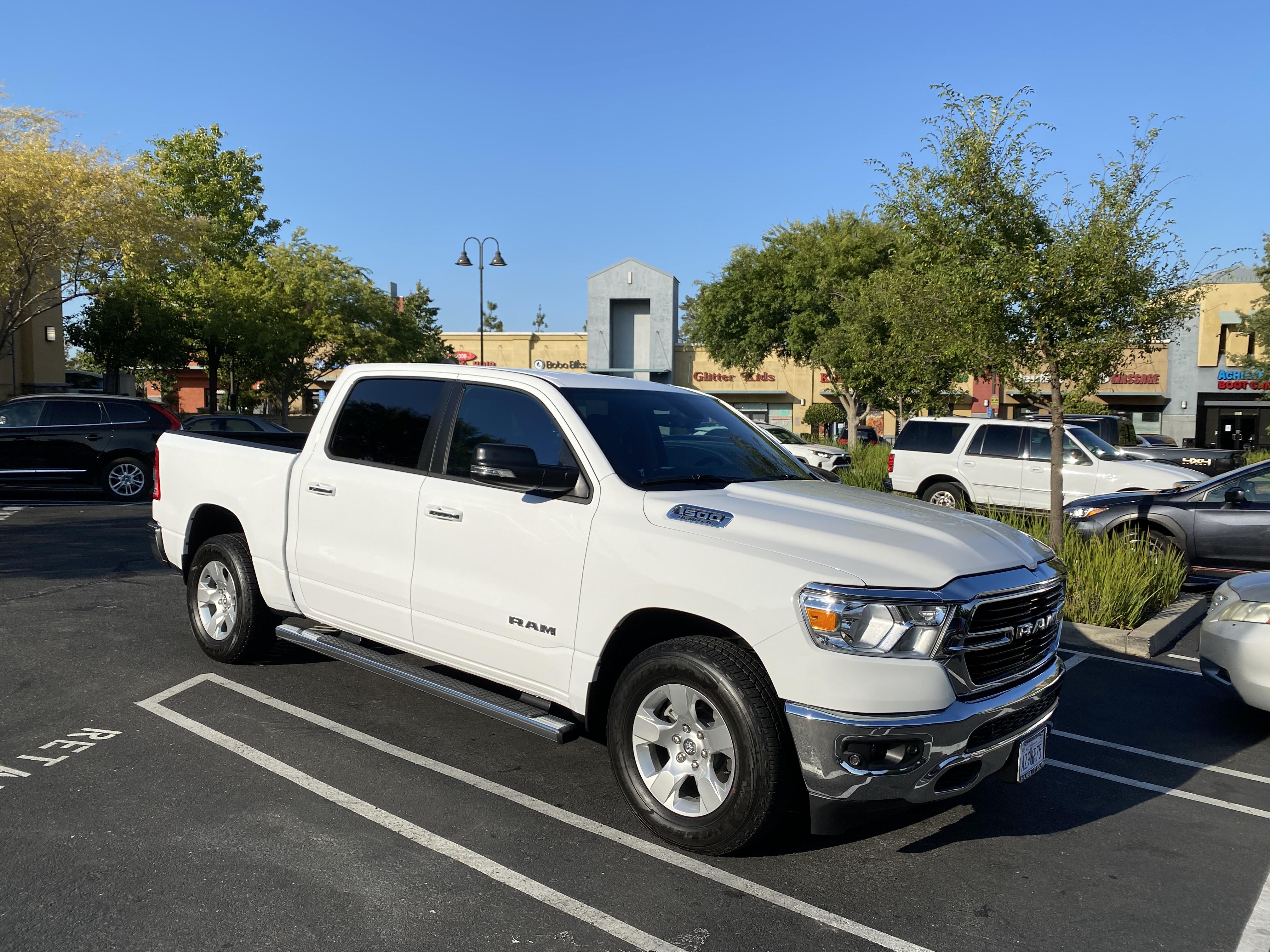

Here is front 35% with windshield 50% under direct sun, not dark at all..
That picture must have been taken in direct sunlight. I am curious how yours looks in indirect sun because my Crystalline 70% looks a lot darker than that.
This is how mine looks in direct sun:

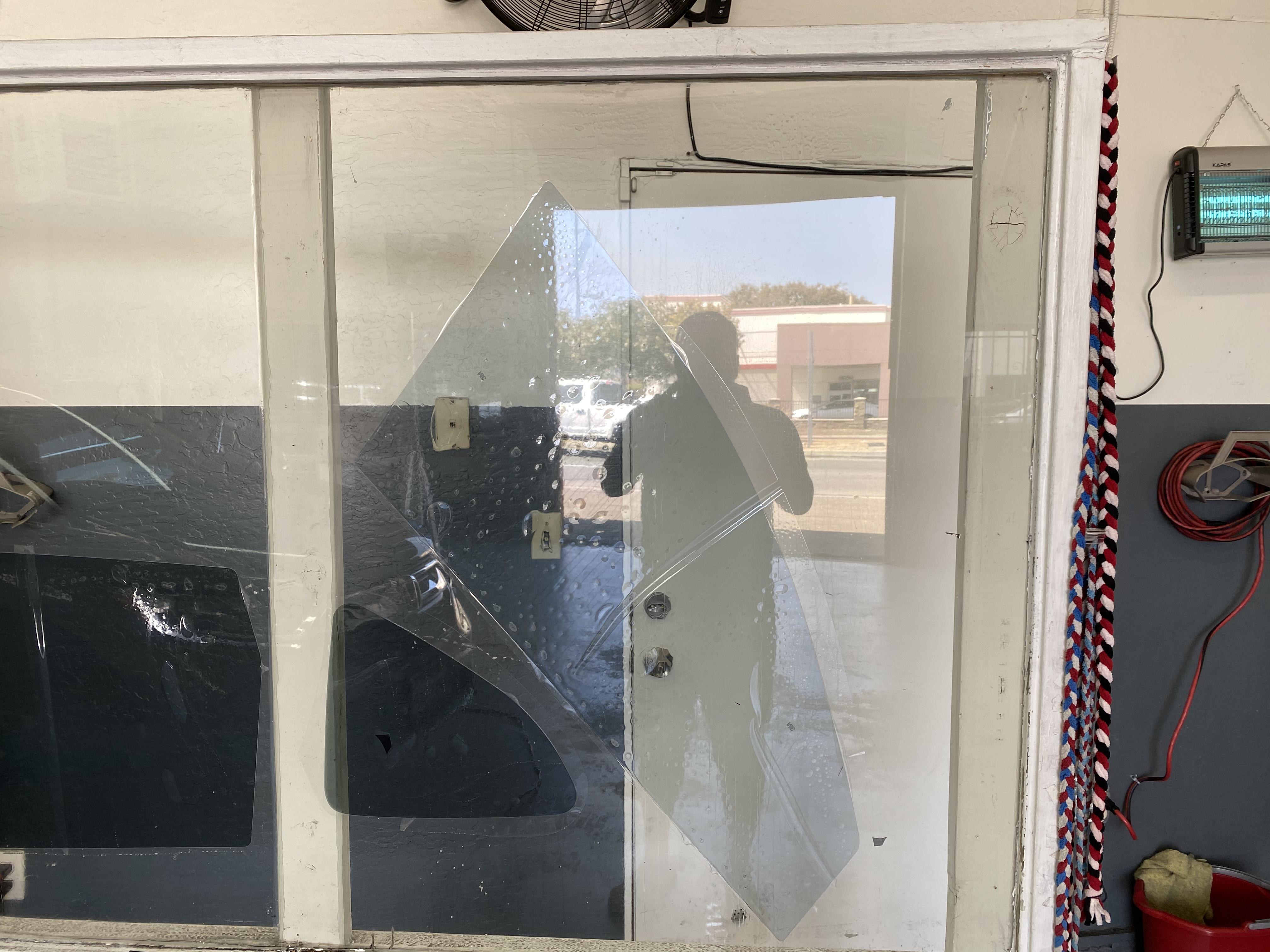

Just wanted to post up a picture of the two films. The lighter film on the board is the Crystalline 70 and the darker prices are the Ceramic IR 35 (45% VLT). I would not consider the Crystalline 70% to be “colorless,” it is definitely noticeable on the windshield so beware.

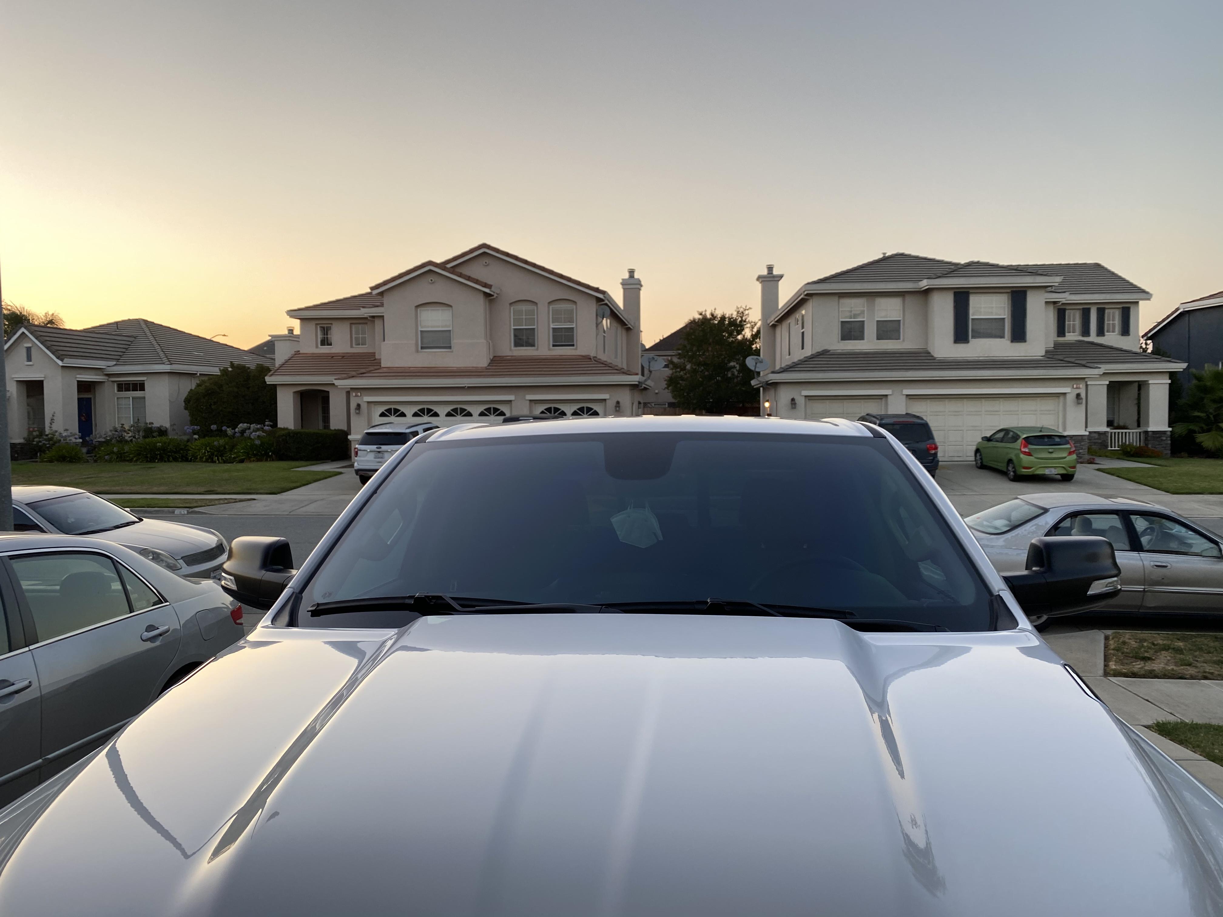

Also, this is a picture of the front windshield around sunset. The bluish hue looks pretty neat but you can definitely see the tint. If you are concerned about tint laws, I would avoid.
