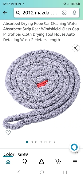

The tint is put on the inside. If they don't put a rope or something to block the water from running down into the dash, it can short out the BCM that is mounted on the drivers side kick panel area. They can also remove it prior to installing.

The BCM is located under the dash on the driver kick panel high up by the windshield. It's protected from outside elements but not from tint installers that squeegee a bunch a water down the bottom of the windshield and channels to the BCM. It can be avoided by sticking water absorbing towel rope at bottom of windshield to capture the water. I'm actually suprised on many folks tint windshields considering in most cases it's illegal(not judging) but I guess that comes with truck modding at times.

I did 35% on the windshield and have no issues. I did double check with the installer a rope would be used and a full dash mat as well. 35% is where it’s at. During the day I don’t have to wear sunglasses and during the night in back country roads I can still see just fine.

In addition to the rope, my installer put a folded up towel over the BCM. I also got windshield tinted for UV.
