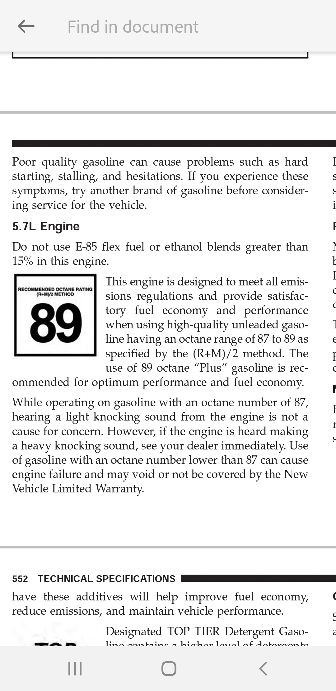

Kidder
Jul 29, 2018
393
237
DFW, TX
For the Hemi, 89 is recommended, 87 is okay as long as there is no knocking.
That's what the manual says. I attached a screen shot from my 2019 manual.
