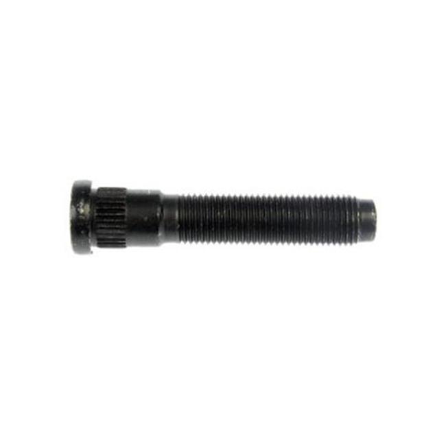

So I am curious what lug studs I need to run 1/2" spacers on my truck. I am struggling to find a part that is longer and matches the m14 1.5 thread. Any help would be appreciated.

I bought 610-530 which are slightly longer, but haven’t installed them yet. They might be too long for running without the spacers and factory lugs, but should be good with 1/2” spacers and factory lugs.

Personally, Id say pass up the 1/2" spacers and go to at least 3/4" that bolt on. Then the most you may have to do is trim the factory studs some.
Did you end up installing them yet? How did they fit?
