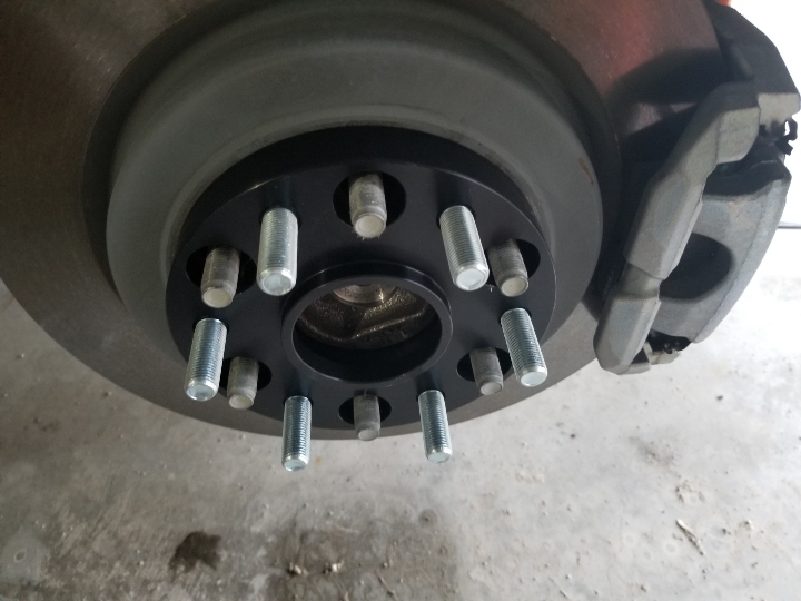

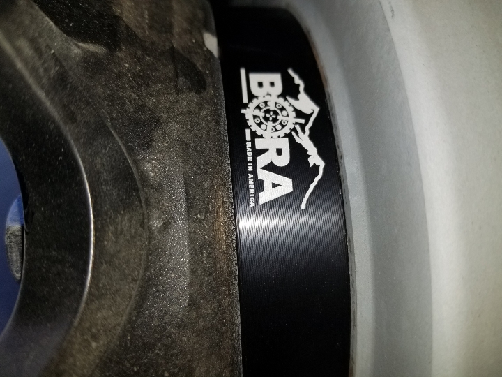

Pictures. @Black19 more pics
I don't have good before pics for comparison so just subtract 3/4" front and 1" rear in your mind.
295/75 R18 on stock Rebel wheels
This is the front with the 3/4" spacer.
My Rebel and BH NE wheels have the same pocket depth.
