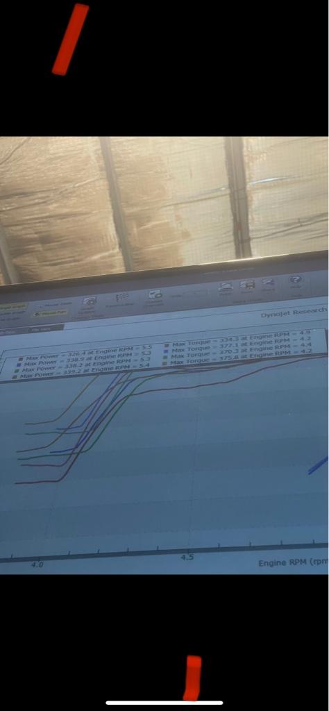

Guys quick update in my Truck. I changed the Y pipe to true daul H pipe gained 14HP and 17 tourqe
In conclusion always go true daul whether x or h pipe
Below the graph
Modifications
Cold air intake afe
throttle body bbk 85mm
ati dumber 15% underdrive pully,
Long tube headers
Catless h pipe
cat-back
with 35 mud tires and 3.92 gear ratio.

The below results after all upgrades CAI,LT headers etc,,
first run without tune the AFR was reading too rich about 10.2

I have ram 1500 2020 5.7 hemi with full bolt with the following upgrades:
Cold air intake afe
Long tube headers
Catless y pipe
catback
After tuning the truck made rwhp 339hp and 376 torque
My question are these number consider normal with modification above?

There are so many things that can effect Dyno numbers. Everything from the Dyno operator no configuring it correctly, not using proper gear, needing tune up, type of Dyno, whether they got the tach signal set up correctly. As mentioned, you can't really compare what one truck did on a different Dyno to yours. If you never got a baseline Dyno, or aren't comparing different trucks in the same Dyno on the same day, it's just bench racing. The proof is at the track or on the street. I've seen Dyno queens that can throw down magical numbers on the Dyno, but could never make a single clean pass at the drag strip without something going wrong.
different variables may affect the results, but in my case, the comparison on my truck, both results are based on 3 runs on the dyno. Then we take the average results of y and h exhaust; also, we test it on the same day, dyno, and tuner. All runs were pulled on 5th
I was thinking of replacing the heavy 35 mud tires to stock tires just to see how much power the 35 are killing 🥲
They are good for comparing different mods on same vehicle when using same Dyno.
