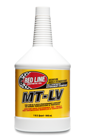

BTW this is my first truck. My guess is I'll be adding modifier. I'll get to it soon and post my experience.
I'm looking at Amsoil. Price is good on their site and I get free shipping and an awesome free tool that may save my life some day. :)
2 qts front
3 qts rear
What about transfer case? What am I using there?
And thanks for the comments. Much appreciated!
I used this in the transfer case:
