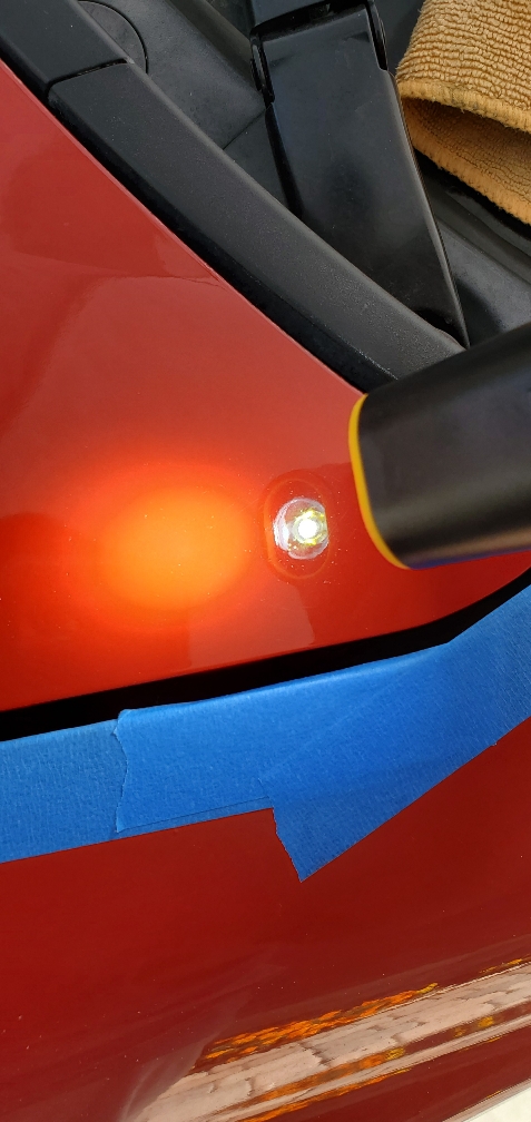

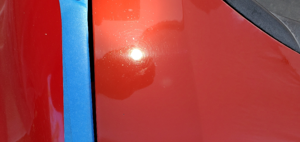

Here are some pillars I corrected a few weeks ago on a Mercedes GL. 3” Griots orange pad and perfect finish:
Before:
57C5E604-AD30-435B-83D5-A89DC1D33A49.jpeg 5CD3E868-721D-4BD8-ACB2-086771ED76DC.jpeg
After:
