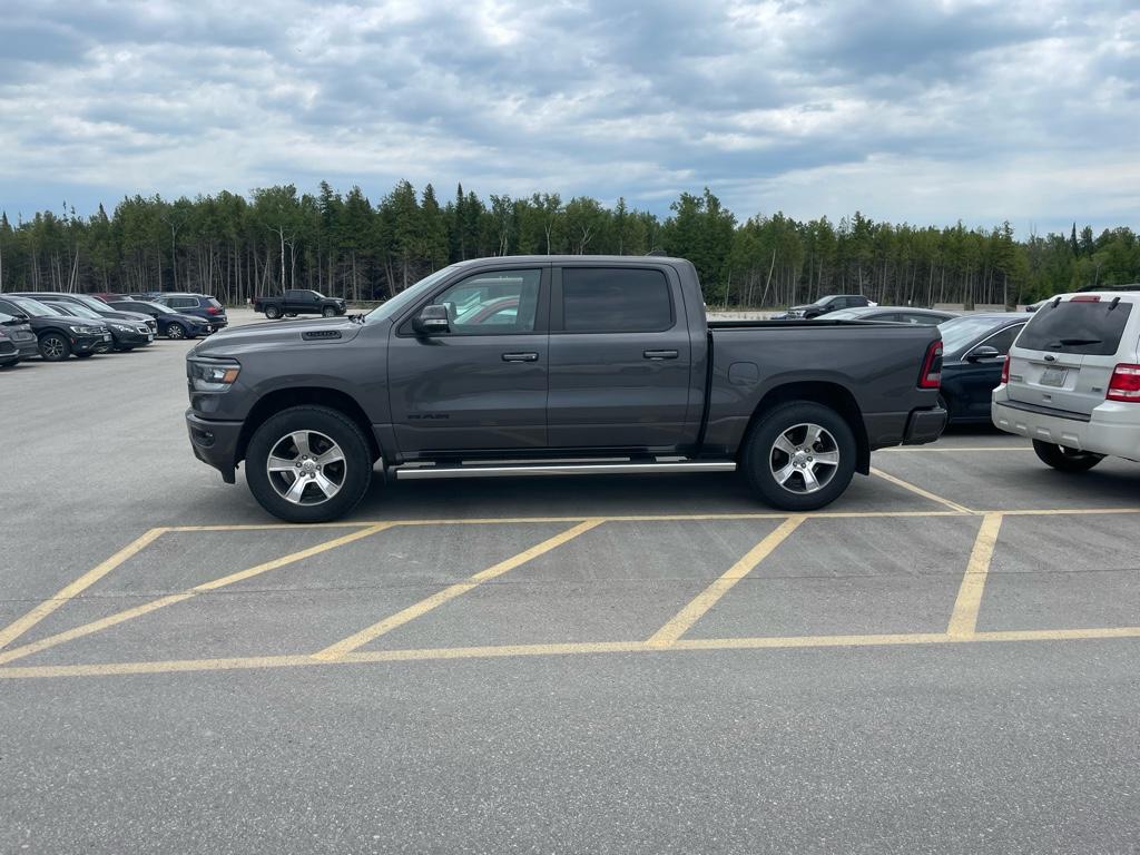

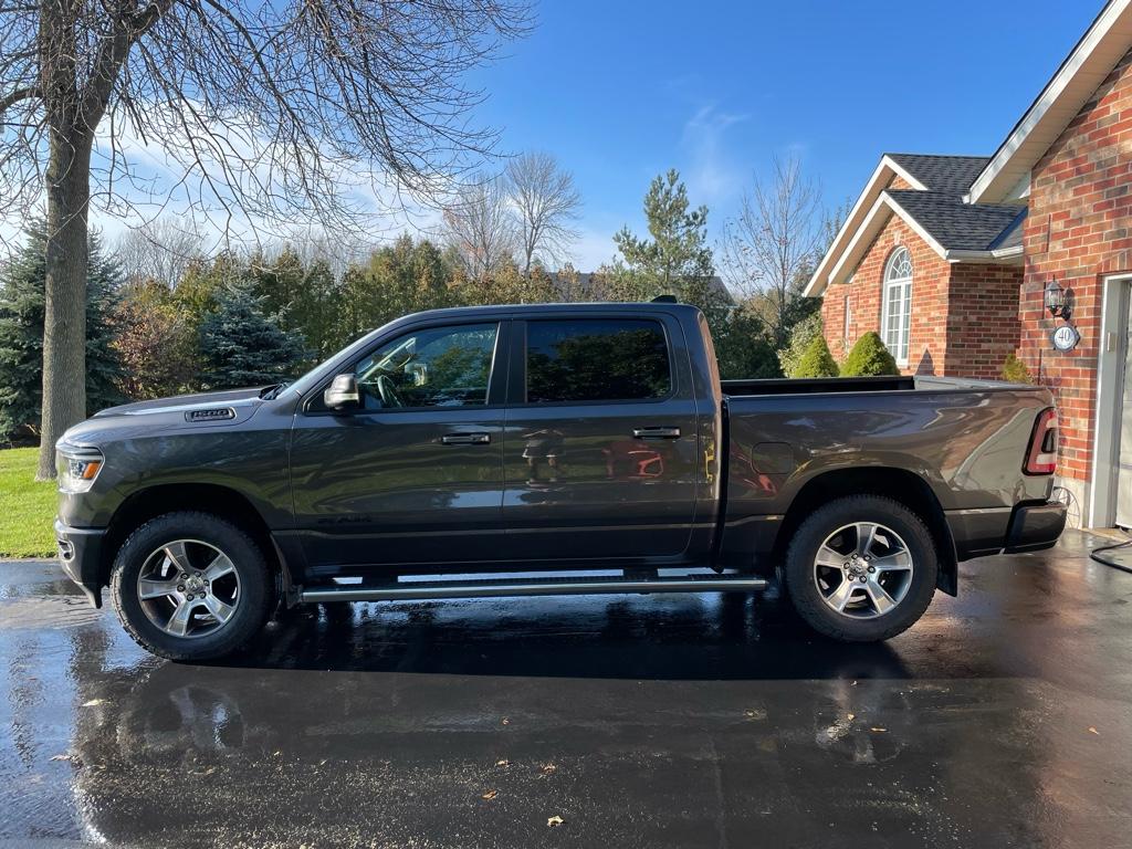

Correct me if I’m wrong and I may be but a top hat spacer doesn’t compress the spring does it. It just extends the shock. There is no spring compressing required on those. I had a shop do it for me and a hellwig bar at the same time. The ride feels the same to me besides sway is gone. Still rides fantastic to me. I did the motofab 2” kit. First pic stock suspension. Second pic w the lift. 275/60/20
You’re correct. The preload spacer is what compresses the spring.
Ah yes ok that makes sense. Thanks for clarifying. Big difference there. Then it was the extended shock that made my ride harsh and not not the compressed spring. It’s been a few years!
Yep, exactly right. My ReadyLift leveling kit with UCA's made the ride slightly firmer, but still very smooth and not harsh at all. Most that go this route like the results.

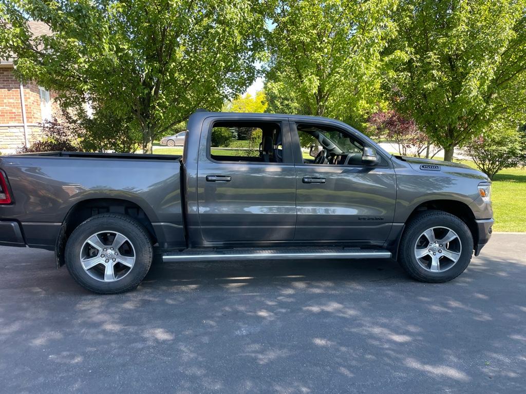

Mopar 2” lift/level….ride quality is markedly better with the Fox shocks….been messing with the PSI for BFG tires and ride quality keeps getting better. 285/65/20

After 2” level with stock tires:
With 34.1”:

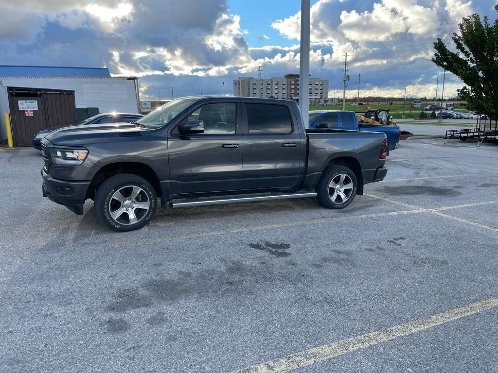

So after 8 months the front level wasn’t cutting it. Towing sled trailer made it squat a fair bit and two weekends ago with two dirt bikes in back was too much for my liking.
Didn’t know what kind of rear lift I was going to put in , not wanting to spend big bucks - I tried a 1” (1.5” spacer) cool spring lift on each side . Just jacked up each side and rotated the rubber donut up to top of uncompressed coil spring .
Given this portion of the spring is always fully compressed (not now however) , ride hasn’t changed much/if any.
Haven’t had anything in back yet - but should sit a little more level when full.
Still like the looks of it on the 34”’s.
