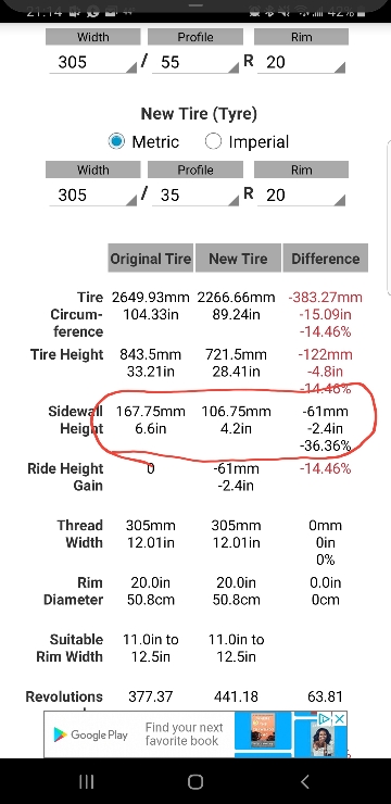

Appreciate the updates....here is one which makes it taller but I really don't know how to explain it the correct way--help guys!!!
That image is comparing 35" to 305 (metric)
35 = diameter (or height)
305 = width
35x12.5 is very straight forward 35" diameter by 12.5" wide.
Metric is more complicated...
305-55
(This may not be technically correct, but it is logically accurate)
305 is the width and 55 is the comparison of sidewall to tread face. As the second # gets bigger, the taller the tire (as long as the first # is static).
55 means that 55% of the surface rubber (imagine a string running from bead to bead...up the sidewall, across the tread, down the sidewall) makes up the sidewall and 45% makes the tread.
35 would be a very short sidewall...35% of the rubber is sidewall and 65% is tread width
This image compares 305 55 to 305 35 showing a 61mm difference in sidewall height.
