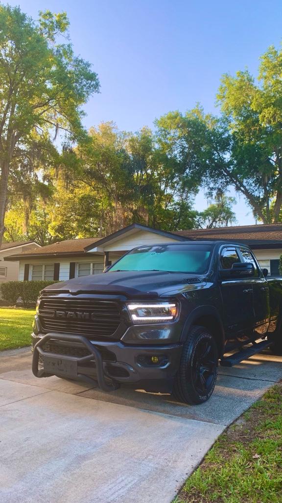

My only question on the VLAN is does the yellow side marker say on when its just in DRL mode? Looks like it in your pic @JBowman but if I can shut that off I'd be a happy camper.
My only question on the VLAN is does the yellow side marker say on when it’s just in DRL mode? Looks like it in your pic @JBowman but if I can shut that off I'd be a happy camper.
Yes, the amber side marker lights are activated with the white daytime running lights. Not sure of a workaround for that. I have seen people apply dark tint over it to black it out, and I think that offers a good look, but I believe you can still see the light pass through when they’re on if going that route.
