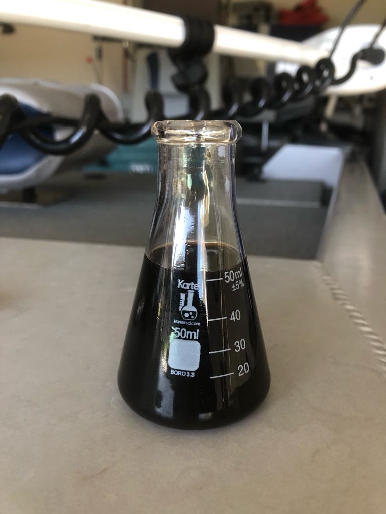

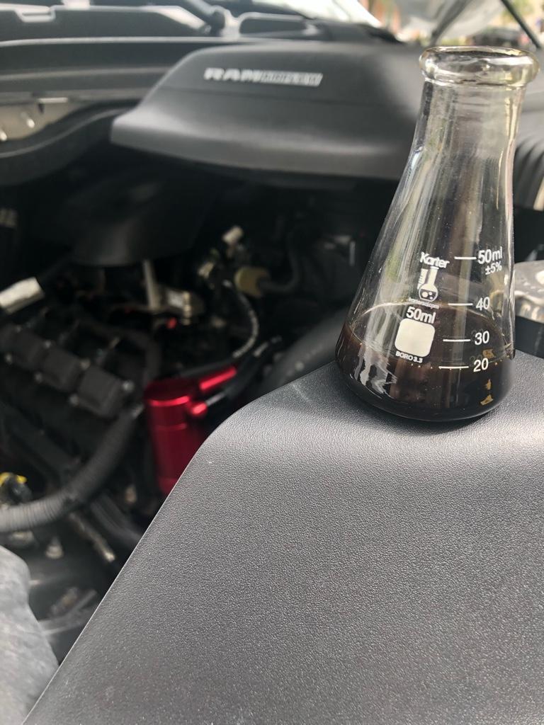

So I’m doing long term tracking of the UPR CC and I’ll update it every 1000 miles. So far it’s been great, cost $130 from the UPR site and the first 1000 miles have shown 20ml collection. For reference a shot poured from a jigger is around 44ml. Amount collected will vary from truck to truck based on environmental factors, type of driving so while I’ll give my results others will vary. Someone mentioned build up on the outlet side of the can hose I have not experienced this but will keep checking every so often. What CC you use or don’t use makes no difference to me but thought it would be cool to give everyone long term results so they can decide if it’s worth it or not for them. I also plan on doing sample analysis as well. Let me know if you have questions or inputs. And yes I know I probably have to much time on my hands.

Update for the next 1000 Miles the can collected 10ml so half of the first 1000 not sure why possibly weather. So to date 30ml in 2000 miles. Next update in a 1000. Once I have 50ml collected I’ll run it through a separation funnel to determine the water to oil content. So far after soaking a magnet no remarkable metal content, which is what I expected but never hurts to check.

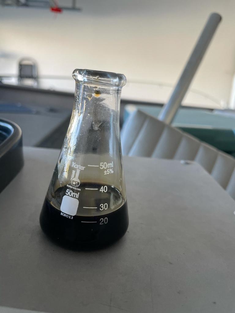

So the update on the UPR CC. 3000 miles and drained 20ml today so 50ml in the first 3000 miles. I plan to keep updating until 6000 or through a temperature change as I’ve been told it will fill more in colder temps. I’m in North FL so I can’t give you guys a true cold weather measurement until I move back to MN next year. After 6k I’ll run what I’ve collected through a sep funnel and try to give the breakdown of the water to oil content. I can say so far, I’m glad this isn’t being recycled back into my intake. It may not stop the light ngoni from working but it sure can’t be good for it either.

Update 4000 miles drained a little over 20ml so now at just over 70mil in total.

At the amount I’m getting every 1000, I would say 3000-4000 is the longest I would wait because of the offset baffle the UPR CC uses. On cans with a non offset you could wait longer. I prefer the offset as it keeps the oil from getting pulled across the baffle and out the exit port. It’s catching an average of 17.5ml every 1000 miles with how I drive. The amount can vary by environmental and driving factors so if you add one the amount you’ll drain will probably vary some. They are vary easy to drain.
