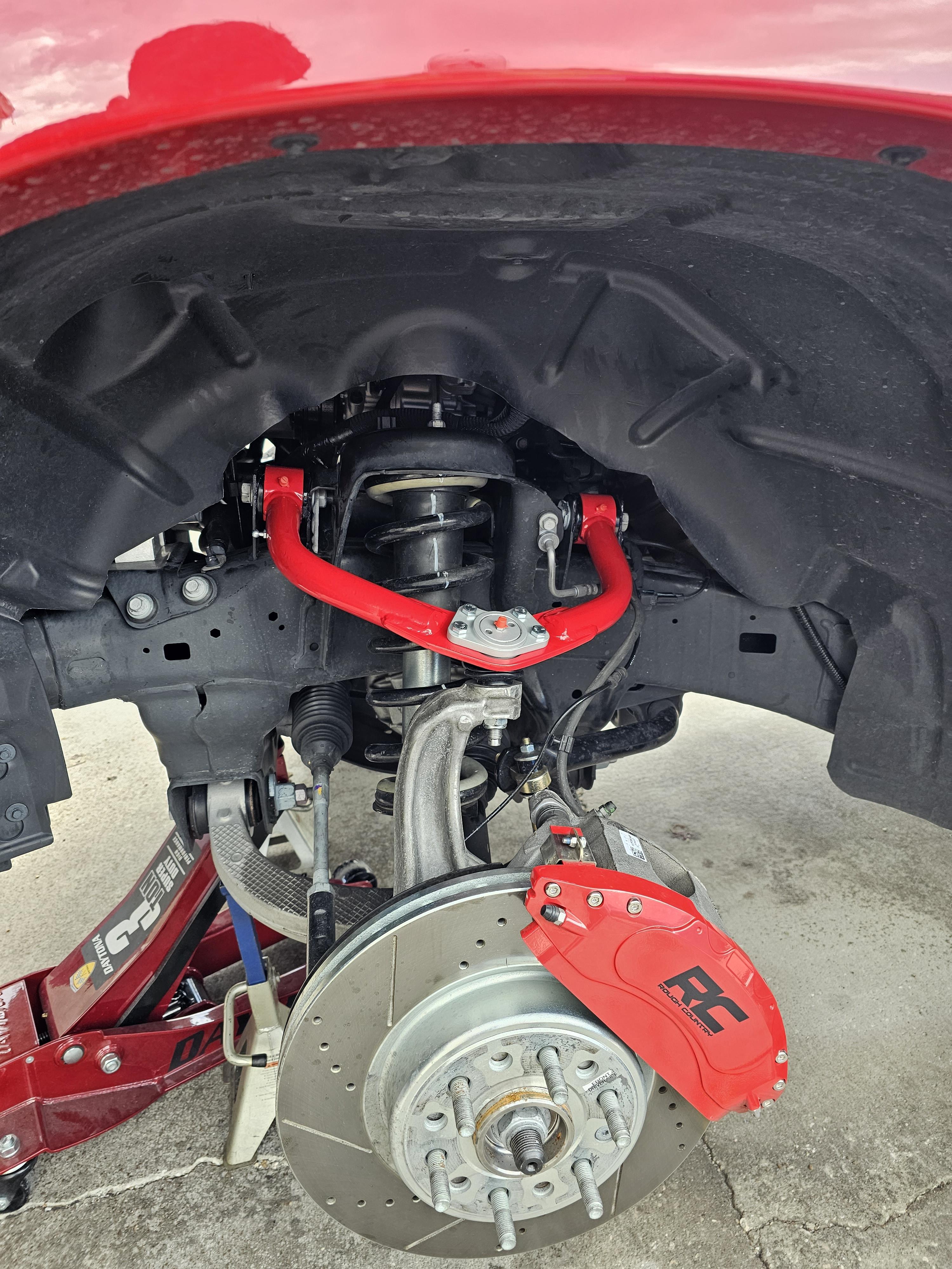

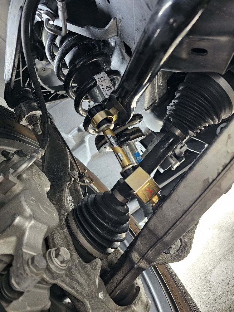

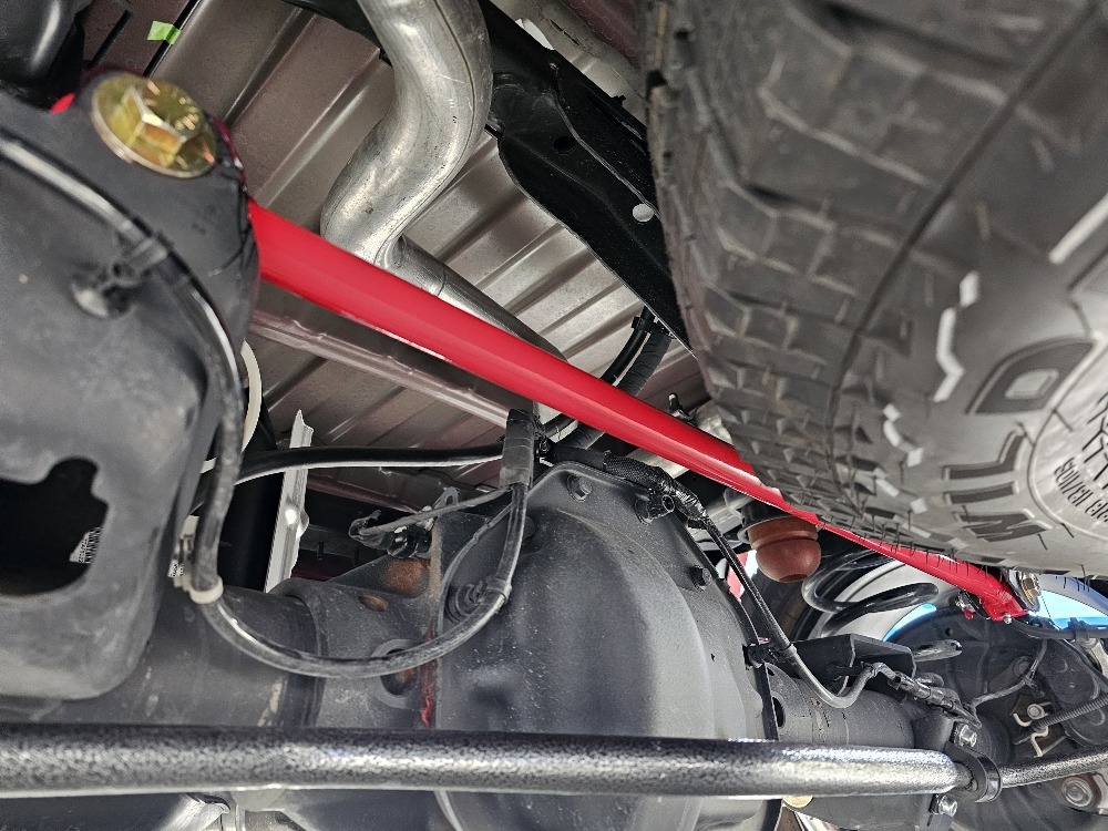

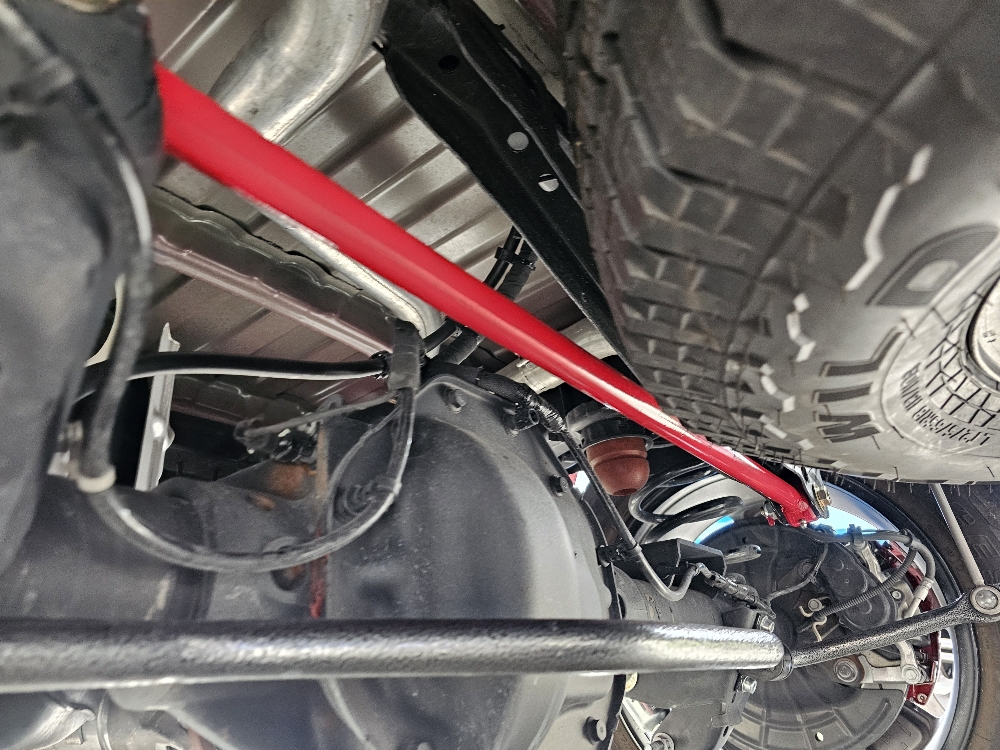

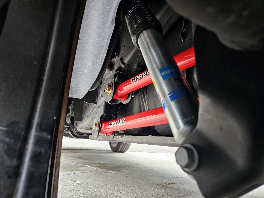

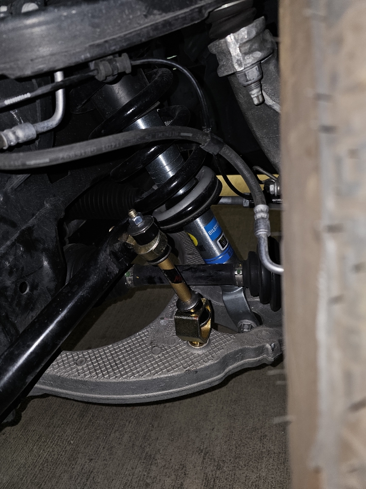

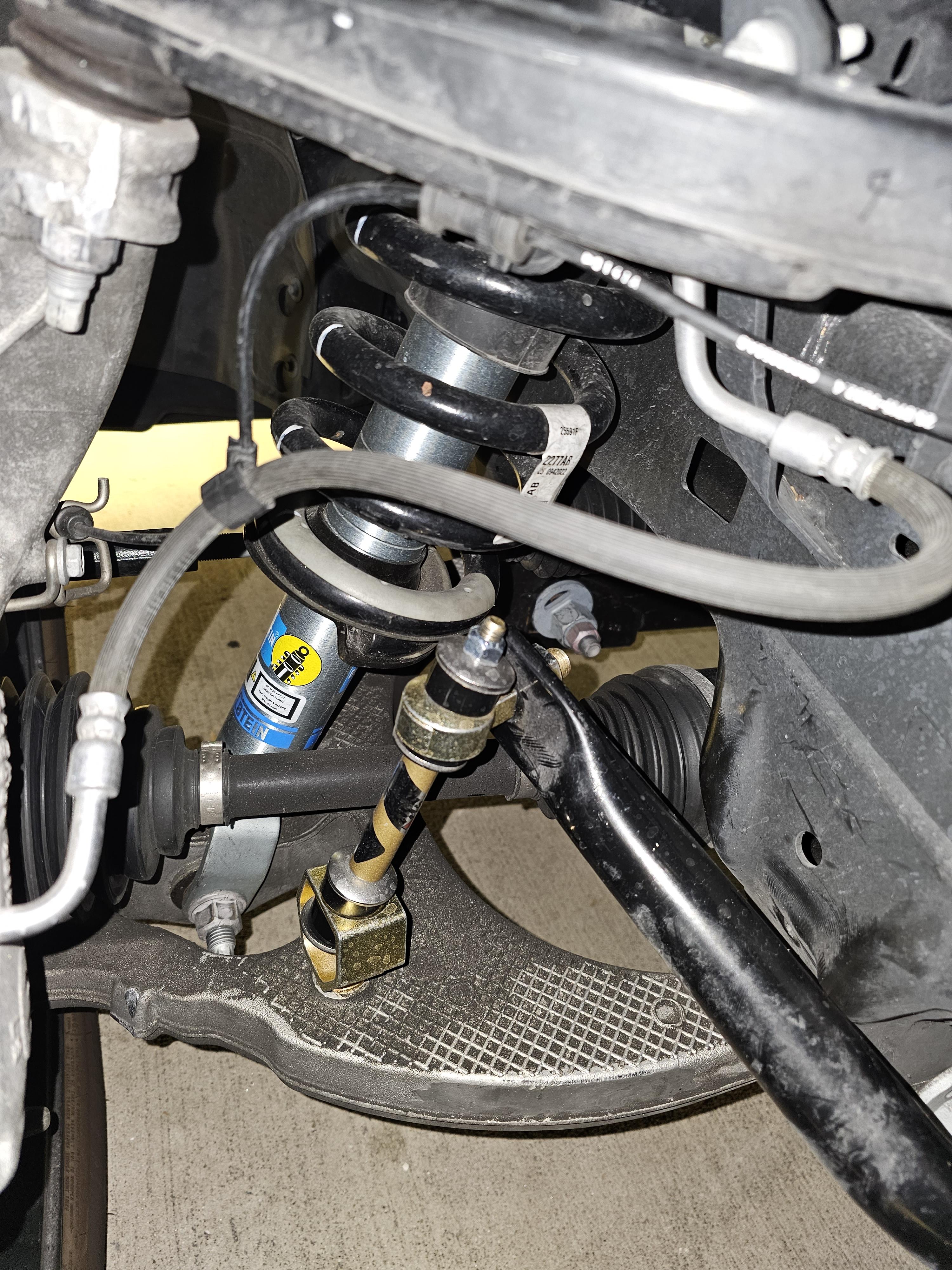

I did Bilsteins 5100 all around with Core 4x4 rear upper, lower control arms, panhard bar and sway bar end links, Hellwig rear sway bar, Suspension Maxx front sway bar end links and JBA off-road front upper control arms, it honestly rides like a cloud.

Do you think the 5100 alone would make a big difference. Or are all the mods you did needed to get the ride right.
The first thing I did was the Bilsteins and that by itself is a big difference

Yeah, a 2500 is a pretty different animal than us 1/2 tons. You may wanna mosey on over to the HD forums for more info. Good luck👍
You can't do coil overs on a 2500. Still, all the big manufacturers will have you covered with suspension. You don't have to lift.
