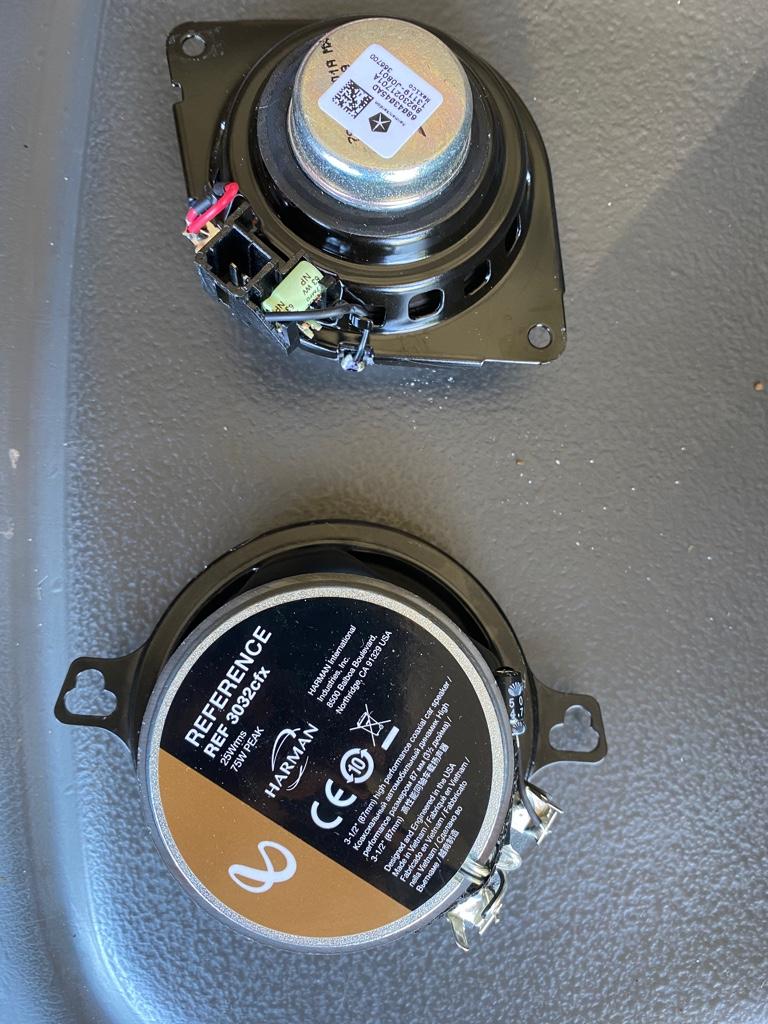

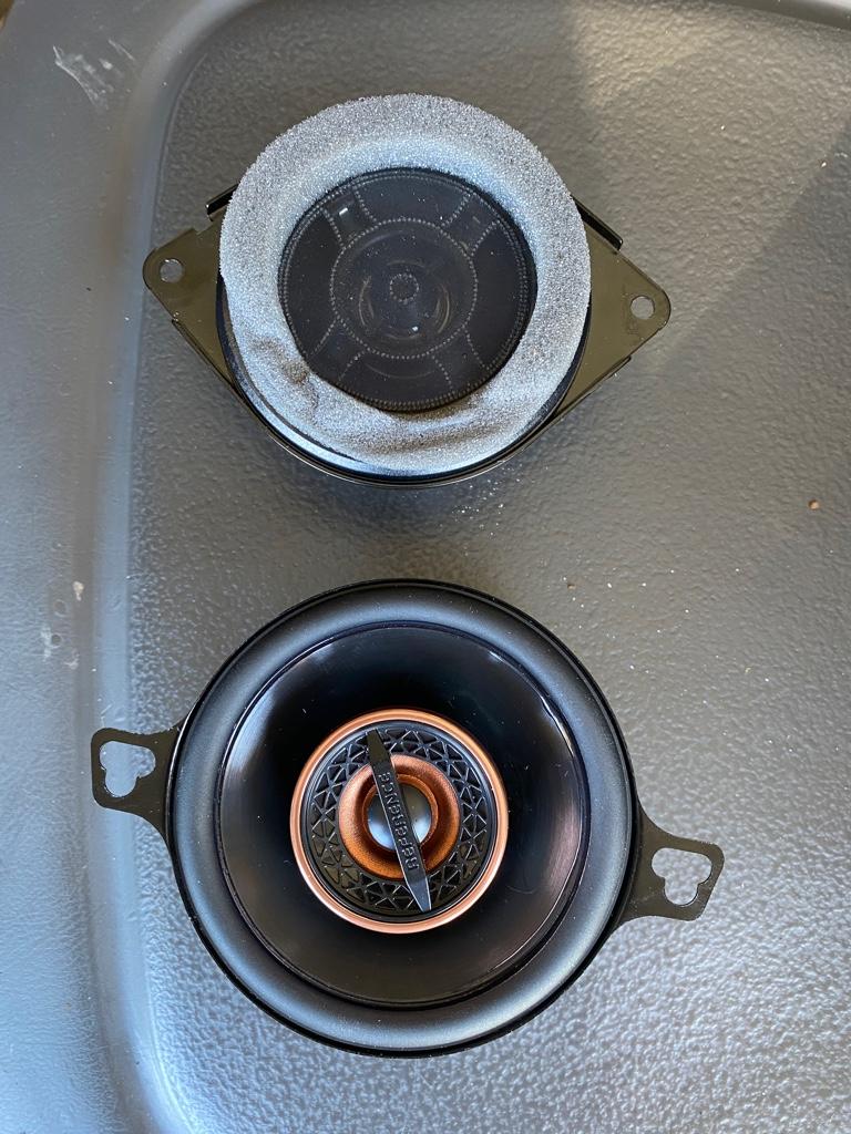

Thought I’d spring for the infinity dash speaker upgrade for my HK system. Wow. What a difference with much crisper and cleaner notes. It also really compliments the stock door panel speakers now since the door carries more mid and lower tones. When I compared the 2 as far as sound goes, the HK speakers sounded horrible. Flat, monotone, not crisp at all. Comparing the 2 physically, I’d be embarrassed to show off the HK speaker and call it a quality piece. I suspect ram paid Harman for licensing the name, but harman did not give them quality pieces.

Tried to replace the rear headliner speakers and of course the infinity 3025 are not oriented in a good way to mount. Bulky magnet and the connect prongs don’t make it easy. Will probably need to drill new holes in the plastic mount plate to make it work. Tomrws project.
Assuming you meant 3032? I ran into the same issue. I did end up drilling the holes in the plastic to mount them.
