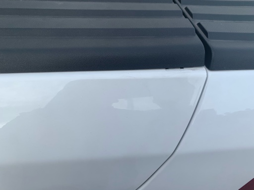

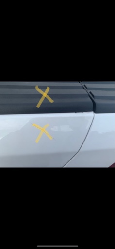

the warping of the top lid has happened to me as well. It has already been replaced once. I have had my dealership report to the Star division. Hopefully they come up with a permanent fix. I still love my ramboxes though and would definitely get them again. They are just way to practical.

do people have more issues out of one side warping over the other? Seems like my drivers side is much worse
Both sides of mine are about equal. One not greater than the other. I have been waiting to see if a fix would come along, but I am going in next week to get the rear wheel liners and hood protector put on and will have them start a case so it is documented. "RAMRON", thanks for the pictures. Mine are about the same as far as the top piece separating and warped. Just not right.
