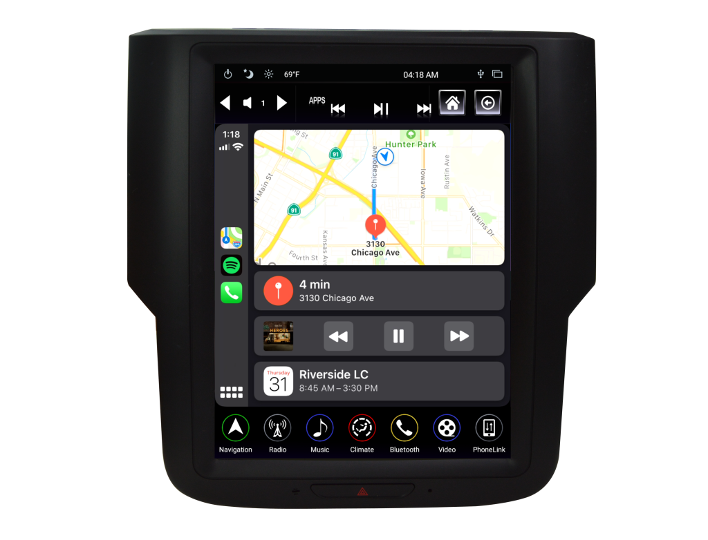

When mine craps out(if/when?) I will most likely move over to the Tesla style. Cheaper than factory by several grand.
ZWNAV Android 9.0 Tesla Car Stereo for Dodge Ram 1500 2014-2019, HD Screen, Car GPS Navigation Head Unit, DSP, Support Carplay, Android Auto, Bluetooth 5.0, WiFi, Fast Boot​
This one is for 4th gen...
FCA famous last words "Update coming next quarter" I truly think they are going to use this until all the warranties expire on trucks with these radios or folks give up and stop complaining. I'm sure an update will come sooner later but as we come to end of uconnect 4 updates are probably going to be non existent in the near future IMO.
On another Ram forum came across the Linkswell that is 4th and 5th gen Rams.
Other than a few questions, I would be looking at it if/when mine goes out.
I think they are out of California.
At the bottom of the page unfortunately:
*THIS RADIO IS INCOMPATIBLE ON RAM TRUCKS EQUIPPED WITH THE FACTORY 12″ SCREEN OPTION*”
With the entire truck integrated into the screen I don’t see how anything but a factory rep lament is going to work correctly... I’ve read other posts where they consider a nonfunctional radio something that makes the truck undriveable because of the safety features that can only be accessed through the radio.
But at least someone is working on an answer to a design problem. Hopefully something will come along in the near future that can replace the 12" when they crap out.
