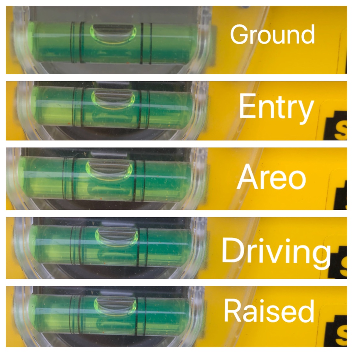

Recently I noticed my truck had a slight lean to it. At first I thought it was an optical illusion or an uneven surface. But today I wanted to check so I got out a 4’ level and took some readings (front and back). It does appear the truck is lower on the left side by about 1/4”. I don’t know if that’s an acceptable difference or something I should get looked at.
Here are pics I took at the different ride heights. Really only becomes noticeable in the two highest settings.

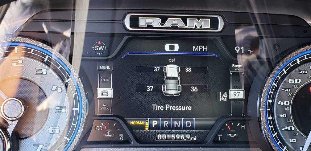

check ur tire pressure unless the sensors are wrong it always shows different numbers and the dealer claims thy filled up to specks
the only bad thing is you can take it to a gas station to fill since they claim nitro in tires instead of regular air

Tire pressure is set to manufacture specifications.

Curious, where did you place your level to take your measurements and did dealership repeat test or confirm visually?

I'd also try rolling the truck forward and backward after each height adjustment. You're going to get some scrub in the front suspension from cycling all the way down and all they way up.

The dealer said the left side of the truck is 1/2" lower than the right. Multiple measurements were taken.
It was escalated to "star" (whatever that is) and we're awaiting a response. I told them to call me when they have a plan and I'll take it back in for whatever repair they deem necessary.
