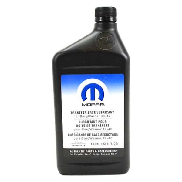

Is there anyone out here knows what kind of t case and diff fluid 5 gen ram uses. I have a 2020 sport.
T-Case: MOPAR BW44–44 Transfer Case Fluid
https://www.carid.com/2019-dodge-ra...nts/mopar-transfer-case-fluid-2763458843.html

What year is the linked manual from? In my 2020 manual the transfer case requirements are:
Also, the REAR differential fluid requirements are different depending if you have 3.21 and 3.92 gearing and/or max tow:
Seems like the Fluid I found is more for the 5th gen in general. 2020 Specify a new fluid for different types of T-cases.
The specified fluid for the 48-11 transfer case is Mopar 68049954AC, which is repackaged Mobil Fluid LT. You can't find the Mobil Fluid LT by itself outside of 5 gallon buckets, unless you get the OEM rebranded packages like the MOPAR fluid here.
RedLine recommends their MT-LV in the RAM transfer case, which is what I use with absolutely no issues:
