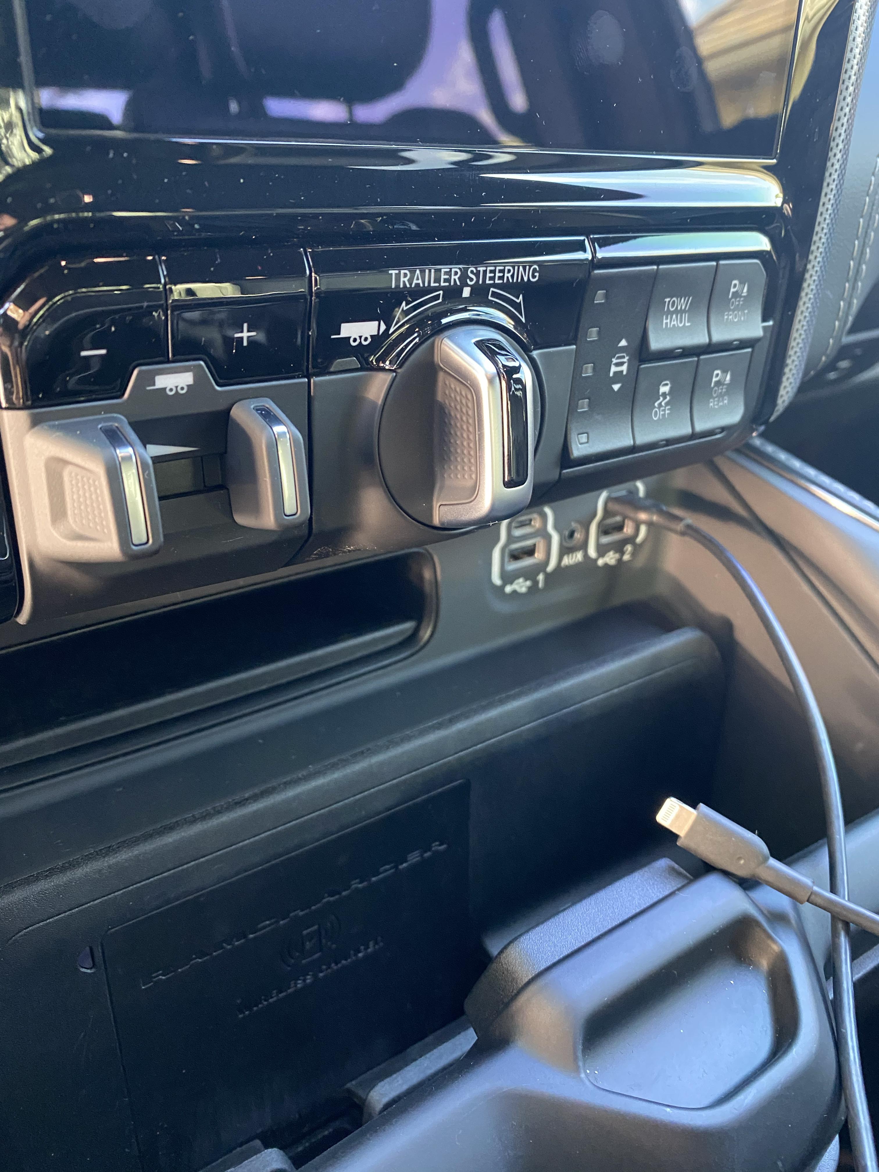

The one I found had this feature but it's really overkill. Having a knob because you don't know how to back a trailer is a little wierd. On my 2019 I used the AlfaOBD software and bought the controller kit for $120. Very easy to do.
