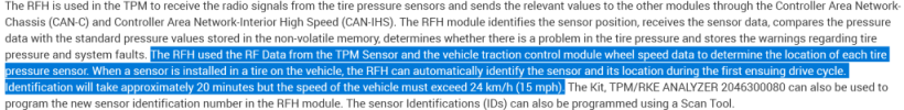

No individual receiver.
Screenshot 2023-07-08 at 20-43-14 Tire Pressure Monitoring (TPM) - Description and Operation (...png
