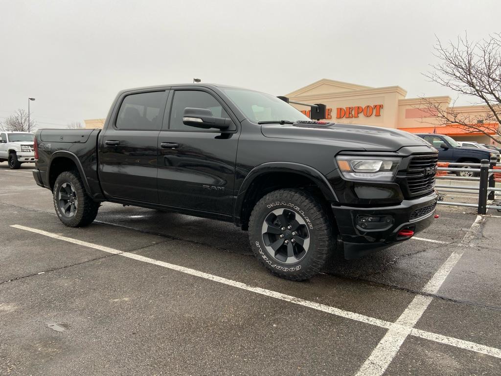

Just had my $33/4 ebay sensors installed by a local tire shop. No issues, had to drive about 15 miles to get them to turn on.

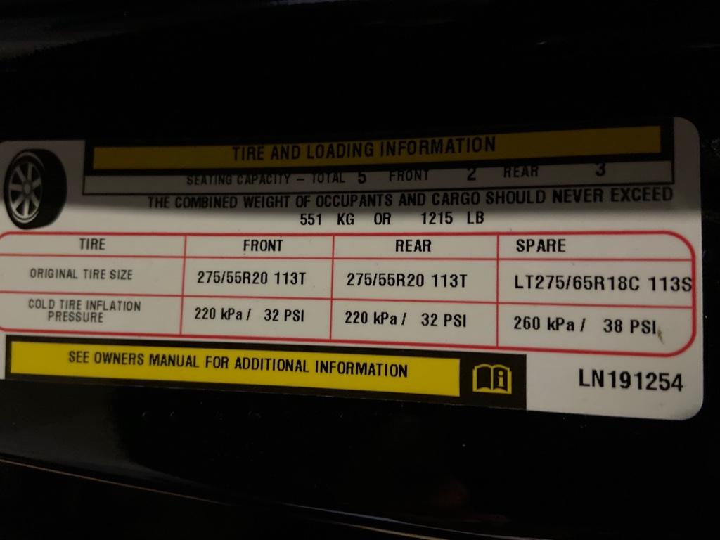

The only problem is, they set the tire pressure spec as the same as my factory tires, even though I’m running larger tires. I’m not yet sure what happens if I “over-inflate” the tires, but I’m about to find out.
You should be fine to over inflate it, they legally can’t alter the values of the TPMS. Even the dealer isn’t supposed to do this. Not to say some places don’t, but this is why most wont.
you need something like the DT Tazer if you want to change the TPMS Settings.
What’s your factory pressure? What pressure are you running?
My Laramie lists 32 front and rear for the stock wheels. I’m now running Rebel takeoffs, which are listed as 55 front / 45 rear on that vehicle, which is quite the discrepancy.
