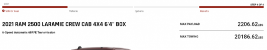

Read this. Then search more on this forum for towing capacities. Then let us know if you have any questions.

factory spec is correct
Click on “ Lookup my vehicle” at the bottom & enter your VIN
