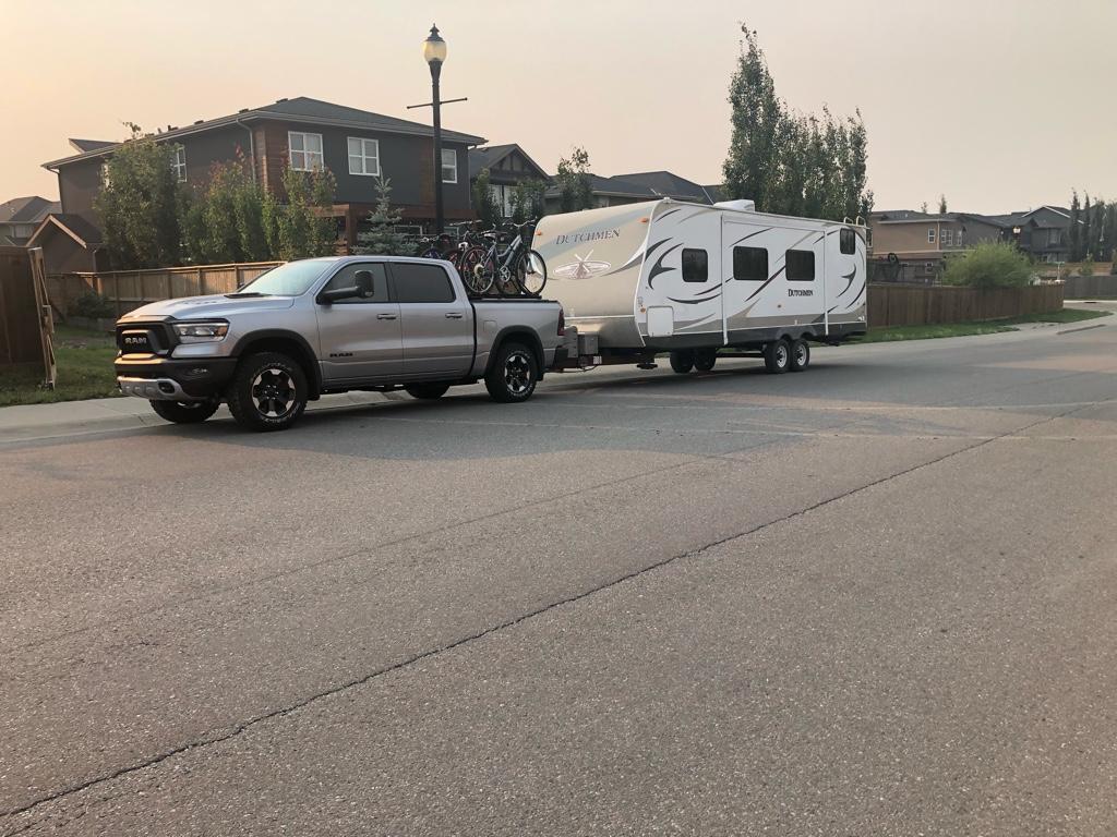

Don’t listen to any naysayers on this one. You have enough truck. Speaking from experience if you leave the truck bed empty you will have zero issues. My payload is 1444 and we travel with a family of four plus snacks and electronics as well, bikes over tonneau cover on a custom rack. With a properly setup hitch this is easy. Btw my trailer is scaled at 7600lbs +\- 100lbs, 33’ long(same layout as yours but with a couch on the slide with the dinette) with hitch weight at just under 900lbs. I use a blue ox WDH that is 100lbs and I am under GVWR.
Nice Setup!
