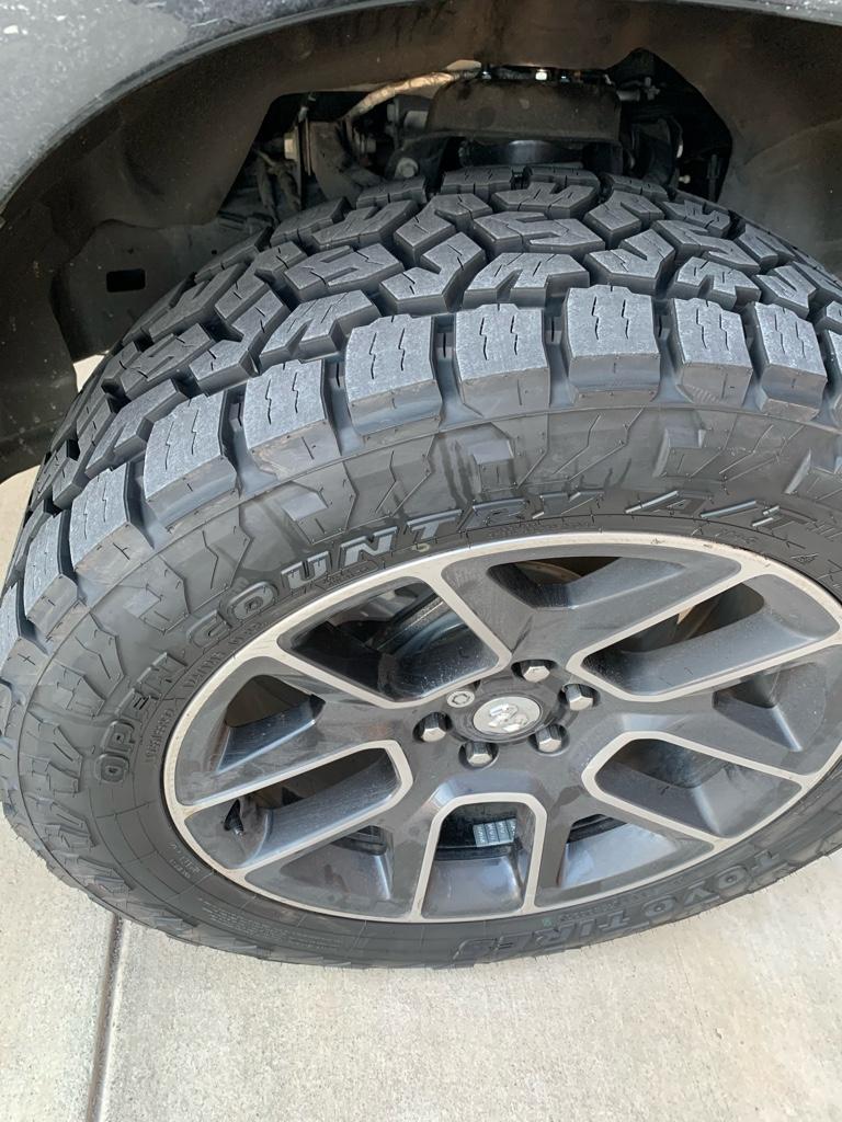

I went with Toyo AT/3 in 285/55/22 if you want to upsize from OEM. Not much snow here in texas but they are snow rated, and they did great in rain , which was must have for me, and they have 50k tread warranty

Any rubbing? I wanted to go with 305/45/22 ridge grapplers. I don’t have a level or lift on my trick. All stock and I don’t want it to rub. Any pictures of the full truck in the image?
It rubbed once at full lock, wheel to the left, in reversing into parking spot, that spot is the small corner of inner fender liner which is easy fix. 305/45/22 should work, I just got the truck, cracked one of the rims on oem stock tires, repaired it and went 34” Toyo for more sidewall! Got all my tire ideas and overall look searching tire sizes in this forum.
I have a 2” motofab level kit on mine.

So I decided to purchase either the 2 or 2.5 motofab spacers. Did you install new control arms?
nice, either would work, I didn’t get new control arms, just the 2” level on and that’s it.
The 2.5 level looks slightly nose up in pictures to me, but doesn’t look bad. A lot of guys go with 2.5 to clear 35” tires
Got ya. I don’t like the nose up. I might go with the 2. 35’s are too heavy for me. I’ll do anything between 33s-34s. Glad to know just 2” spacers in the front will clear 34s. Any other pictures you may have of your truck you can share? Also close up of the tires? I would highly appreciate it.
