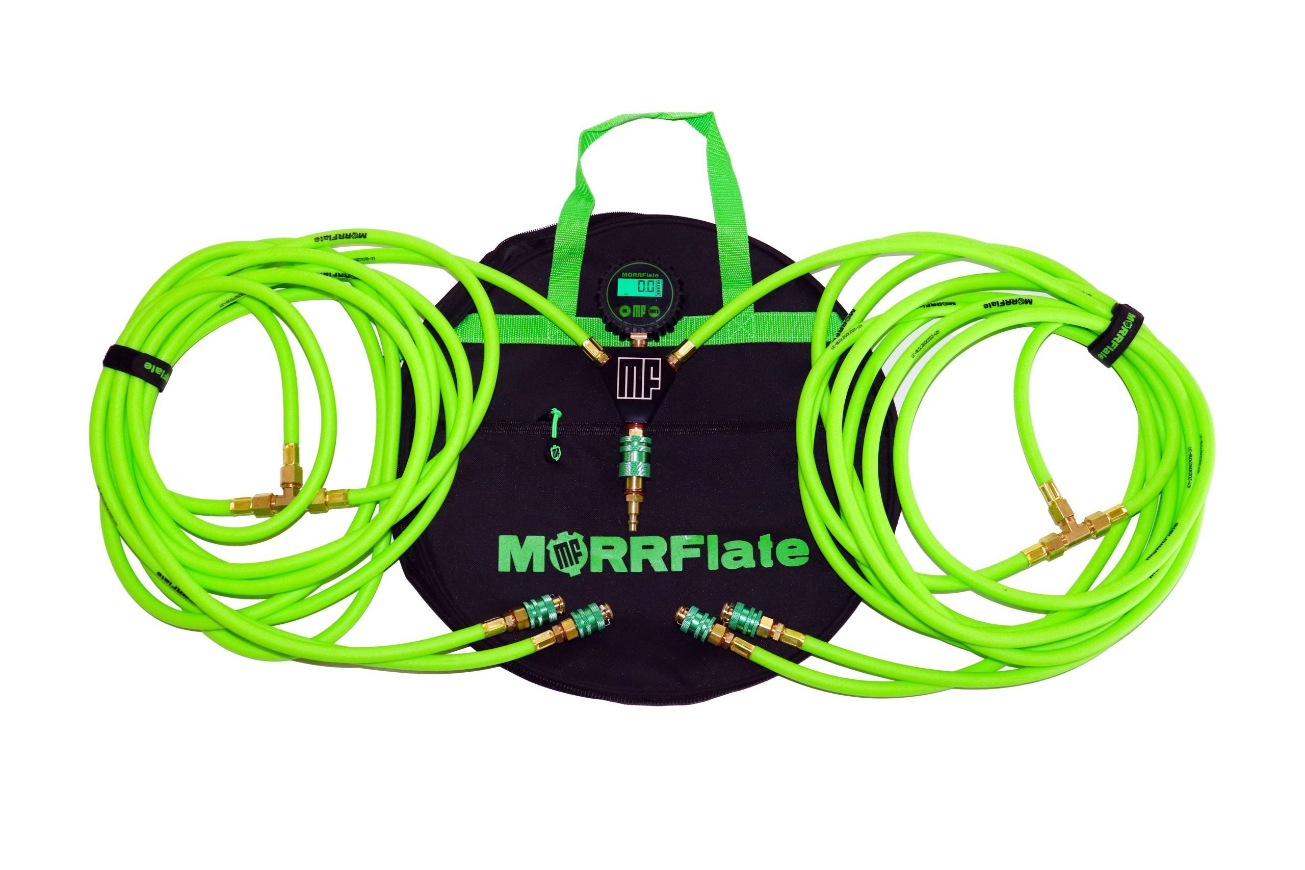

i ended up turning it off because when i'm airing down for trails the flashing hazards are annoying and when I'm airing up the horn would randomly honk before the set pressure is reached. I was ok with it but my friends complained every time lol
so i just rely on my Moorflate gauge and it's pretty accurate.
These are what I use:
This allows you to do all 4 at the same time to ensure equal pressure on all 4 tires.
The included gauge is accurate; i compared the pressure shown on the gauge vs the dash and they're the same.
