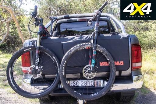

I'm not sure what you are looking to do but hopefully this info helps or leads you in the right direction.
heliinstructor
Feb 4, 2021
87
91
Thanks Jako. Actually tailgate pads are for transporting mountain bikes so that your tailgate doesn’t get scratched up.
10-4, thanks for the education. I looked up Yakima to get an idea what you were talking about but they had a lot of items.
