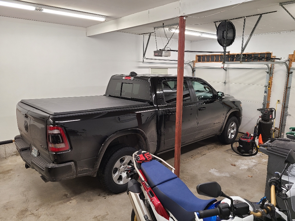

Yes, I use a set of 18 inch wheels from a 2019 Big Horn for winter use on my Limited w/Black Appearance Pkg. There are guys running Rebel takeoffs that work fine, (18 inch with 33s). There are several aftermarket 18 inch wheels that will not work and that's why I went with buying a set of used 18 inch Ram wheels.
Yes, I use a set of 18 inch wheels from a 2019 Big Horn for winter use on my Limited Night Ed. There are guys running Rebel takeoffs that work fine, (18 inch with 33s). There are several aftermarket 18 inch wheels that will not work and that's why I went with buying a set of used 18 inch Ram wheels.

Here's a pic of mine with Cooper Discoverer AT3 tires, oem size. I might sell them if I sell my house this summer. Where I'm going I probably won't be needing them anymore.
