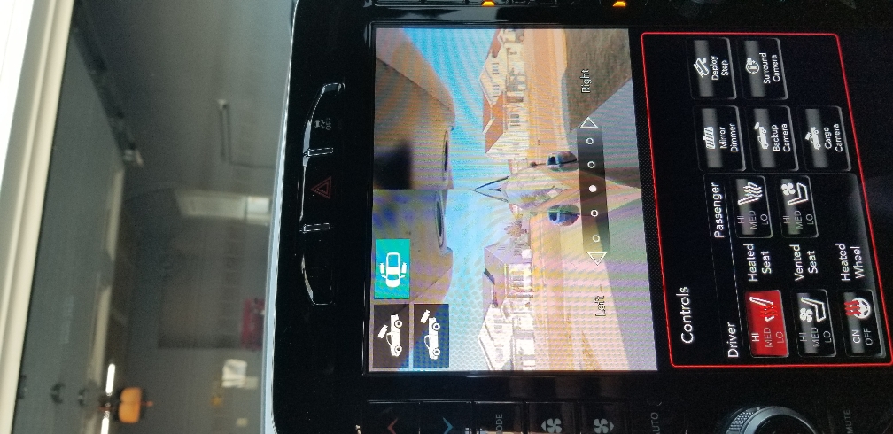

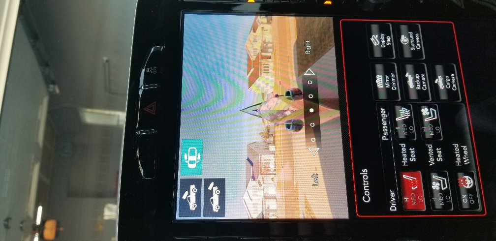

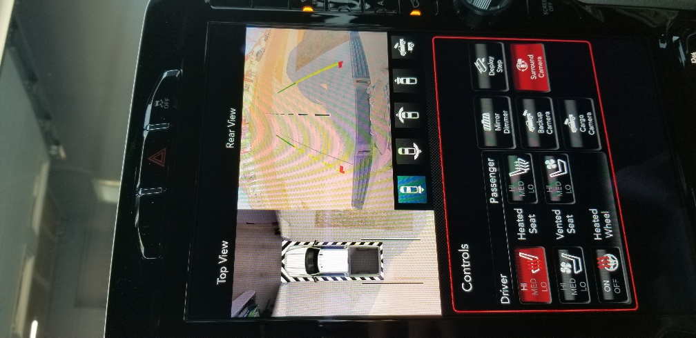

My truck fit very tight in the garage too, i folded mirrors to enter in the garage no problem with the 360 cameras. cameras are under the mirror that not cause any interference with camera.
So your image for 360 does not change at all when you fold your mirrors in? When I fold mine in the camera is on the folding part so the image on either side of the truck rotates as the camera rotates Which makes the 360 kind of useless when they are folded in.
Second and third picture its with folded mirrors, first picture its with unfolded mirrors no changes.
Paul yours looks different than a 2019. Is yours a 2020? Of possibly you have new software on the truck (this could be fixed with a software update).
Mine its late 19, 2500
The 1500 and 2500 360 camera setup are different, the side camera on 2500 is not on the side mirror therefore does not effect the picture whenever it folded or not.
