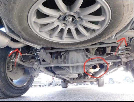

Bought a used 2019 blacked out LoneStar from out of state. Loved the huge start up rumble but driving around sounds like a monster truck rally. I want a great rumble but not so much drone. I don’t know much about exhaust. I’m thinking they cut out the muffler but here’s a pic if anyone can tell me what I have going on. Not sure how the previous owner could stand the drone after a few minutes. Or could I solve the drone with some sort of resonator? Appreciate any advice from someone who know exhausts. thanks 4BB29718-BDEF-4371-903C-086E7218E771.png4BB29718-BDEF-4371-903C-086E7218E771.png

I’m confused is that part of the muffler to the left of the spare?
It seems like the original muffler system is still there. To the left of the spare and another on the right but I’m thinking those two down pipes in the middle of the chassis are the issue. I have to get under for a better inspection bc I can’t tell if there’s a third pipe that still goes to the original mufflers. (Which wouldn’t make sense to me anyway)
Can't tell for sure since you don't have a pic of everything, but I'm willing to bet they left the original tips & rear resonators in place so the rear bumper cutouts didn't look empty and cut the exhaust off after the muffler (maybe replaced that muffler too) in the middle. It looks to be dumping straight down from there. There will be no third pipe. If that's the case, a good muffler shop should be able to reconnect it to the rear and quiet it down some.
Looks like the original owner removed the pipes from the muffler to the left & right pipes with the resonators which is probably why you’re hearing the drone. Take it to a muffler shop and have them install new pipes from the muffler to the two output pipes and you’ll be back to stock.

Yeah that’s definitely not the factory muffler either so that would explain it.
Aftermarket muffler with outlets turned down just before the axle. Factory pipes with resonators are still there. Have a muffler shop connect the turndown to the rear pipes and you should be good. Looks like the muffler is probably a magnaflow too so it should sound pretty decent when it's all connected. Could have them cut out the resonators too and it would probably be about perfect.

Perfect. Exactly the insight I needed! Much appreciated.
I was gonna say "Flowmaster with turn-downs", but yeah... either way. That's why it makes your eyeballs vibrate.
Once that's connected back to the stock resonators (the ones in the back) it should tame the "thrum" quite a bit.

shop said I’d need to replace the muffler because it needs a single out pipe to hook back up to the factory pipes. I’m hoping I can still get a healthy rumble without the extra brain damage.
