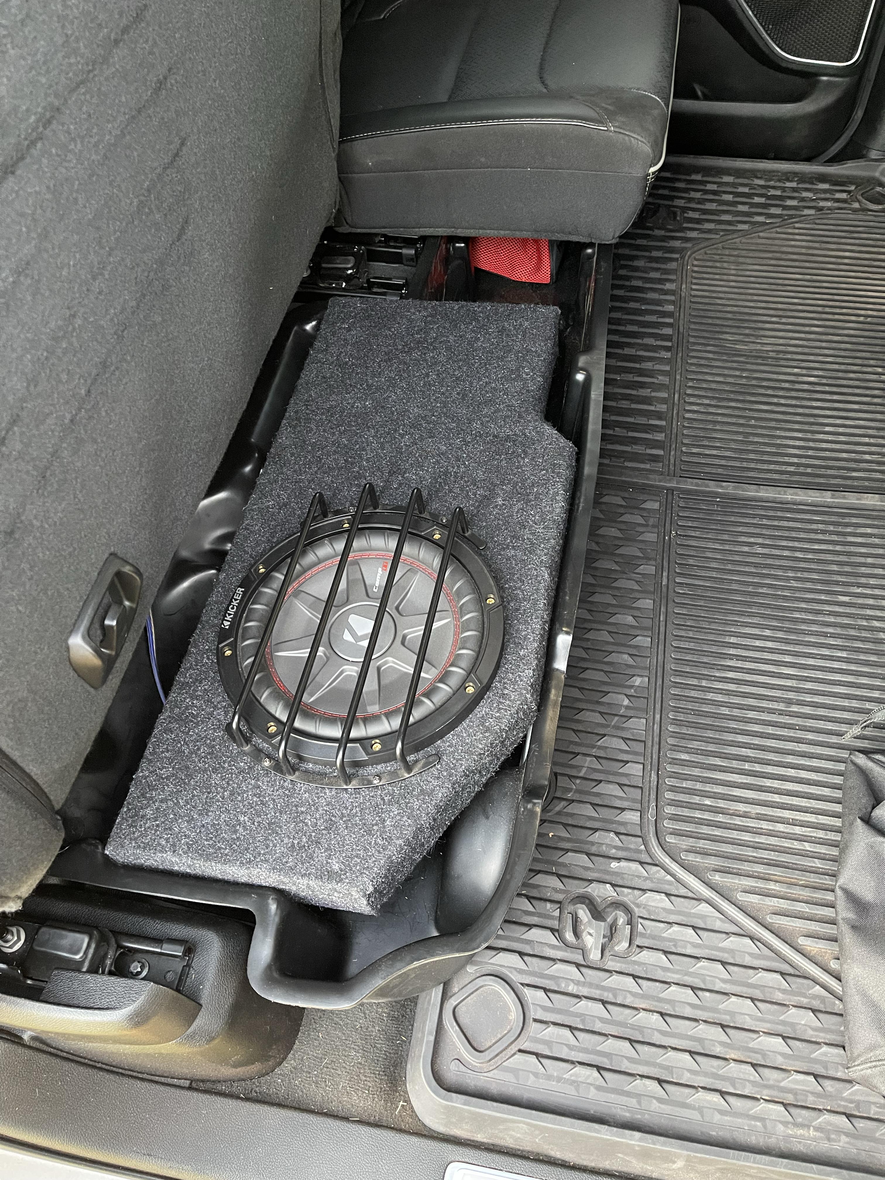

I took a different direction than most. I’ve got the Du-Ha storage box and modified the Atrend 10” sealed box from my previous ‘13 crew cab to fit inside of it. I had to trim about 6 inches off the right side of it and reseal it to fit inside the Du-Ha. It actually fits quite nicely and still allows the seat to lay down fully flat. I still have ample amount of storage on the driver’s side as well as underneath the right half of the sub box. I use the space behind the rear seats for longer items (clothes hanger bar, cargo bar, snow brush, etc.). I have a toolbox in the bed so I was not as concerned about preserving interior storage space.

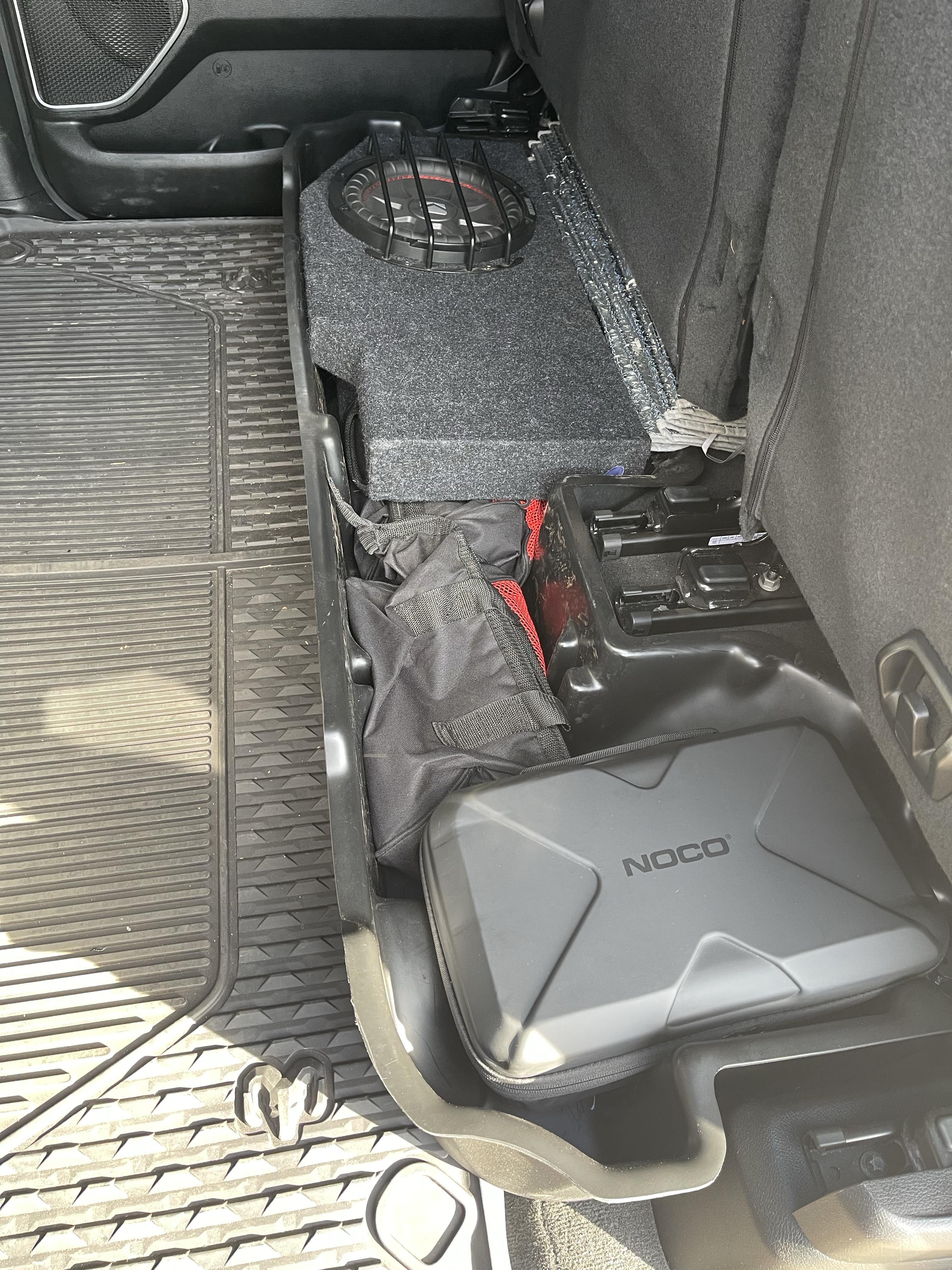

Similar to MoreOvalteenPlz, I put a sub under the rear passenger-side seat. I built a custom box with mdx board, glue, silicone, and some speaker fabric. It cost me all of $35 in supplies and my 10yr old daughter had fun working on a project with me. What I like is that when I need the space, I can easily disconnect the sub box and throw it into the bed or my garage if needed.
