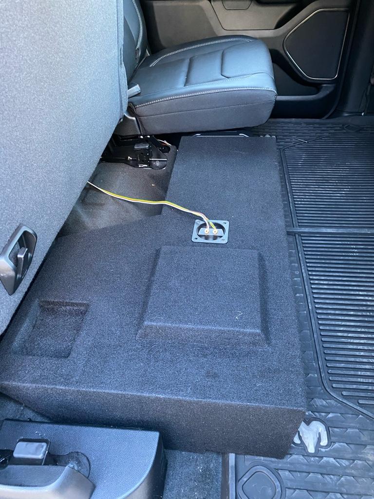

I will say that unplugging the stock sub sounds way better. 4 6x9’s put out plenty of the mid bass at the same frequency the stock sub is. You will still lack the true low end. Also I've read where guys asked about plugging an aftermarket sub to the stock sub harness and don't think anyone actually did it. I tried it with the new box/sub out of curiosity and it sounded terrible. Doing a frequency test from YouTube the new sub cut out all together around 60hz.
Anyways I searched for a long time for something to fix the bass in this truck. I didn't want dual subs, anything obnoxiously loud and wanted to keep the project cost under $1000 with installing it myself.

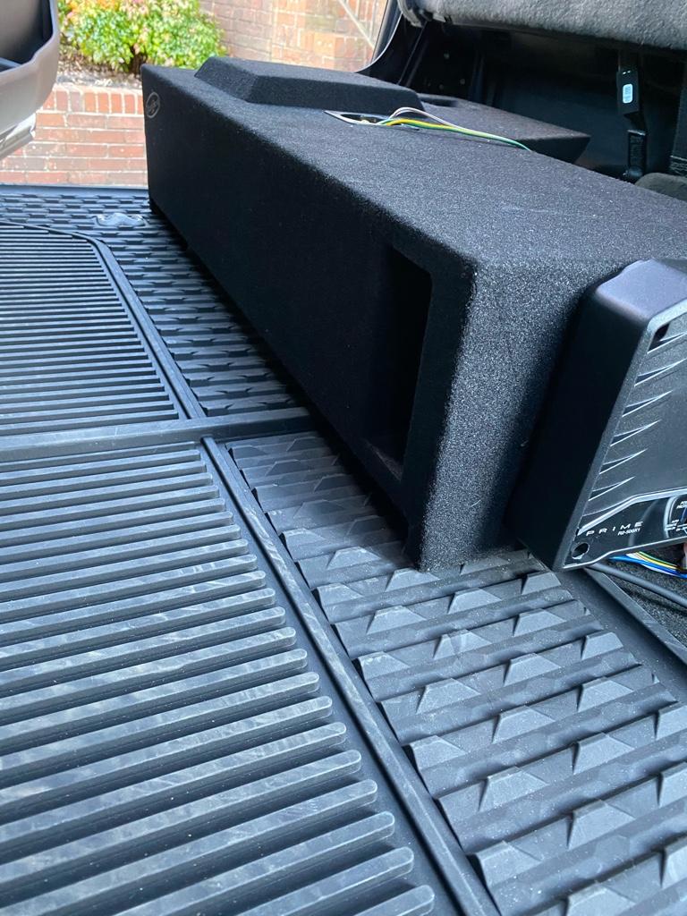

The box:
ground-shaker.com
Brand- Ground shaker
I got the box for a 10”
You can get it for a 10”, 12” or the for solo-baric
Tuned to 32hz
1.12 cubic ft
$215 shipped
Shipping 3-4 weeks as they are made to order.
Sub:
JL audio 10W0v3
Recommended Ported box volume is 1.125cu/ft
25 - 250 hz
300w RMS
Amp:
Rockford Fosgate R2500x1
Interface:
Amppro ap4-ch41

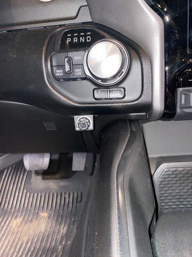

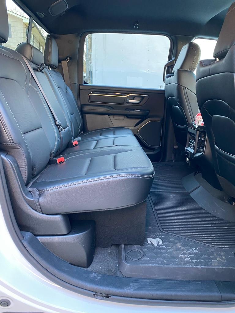

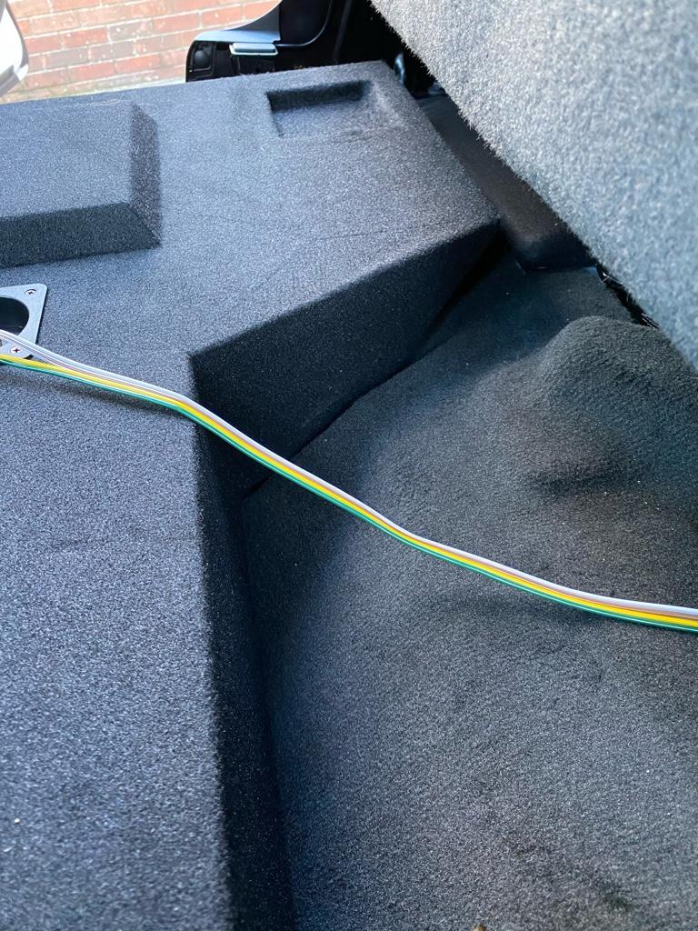

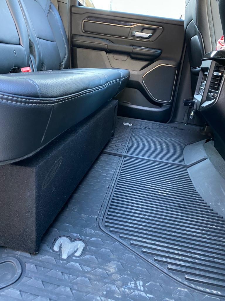

The install took about 5 hrs and was actually surprisingly easy. Except for the 12” screen removal. That was gut wrenching. Two screws and Swift full body yank. Interface is mounted above my pedals. Ran all the wires in the plastic cover thing along the bottom of the door opening. I also mounted a remote under the shifter knob area. I had to remove the fold out storage for this box. Not an issue for me as I don’t use this truck for work and will eventually get mountable boxes in the bed. My daily driver is a GMC Savannah 3500 extended with a 6.6 duramax
I will say I was hesitant before installing that this would still not be the bass solution I was looking for, either it being too much or not accurate bass being ported and aftermarket.
Hands down would recommend this to everyone. It is tight clean bass while hitting the lows at all volumes. It fills every void from the H/k system in every low frequency and is completely balanced. Don’t get me wrong with the gain on the amp turn half way you easily get the head turning bass. However even loud it’s still a very clean sound. Anyways hope you guys like my Review and feel free to ask any question. Also this is a great forum
lots of good and relevant info!
This is my first car sub install and still need to clean my wires up a bit and get a proper wire to the sub. I just used what I had for the time.
