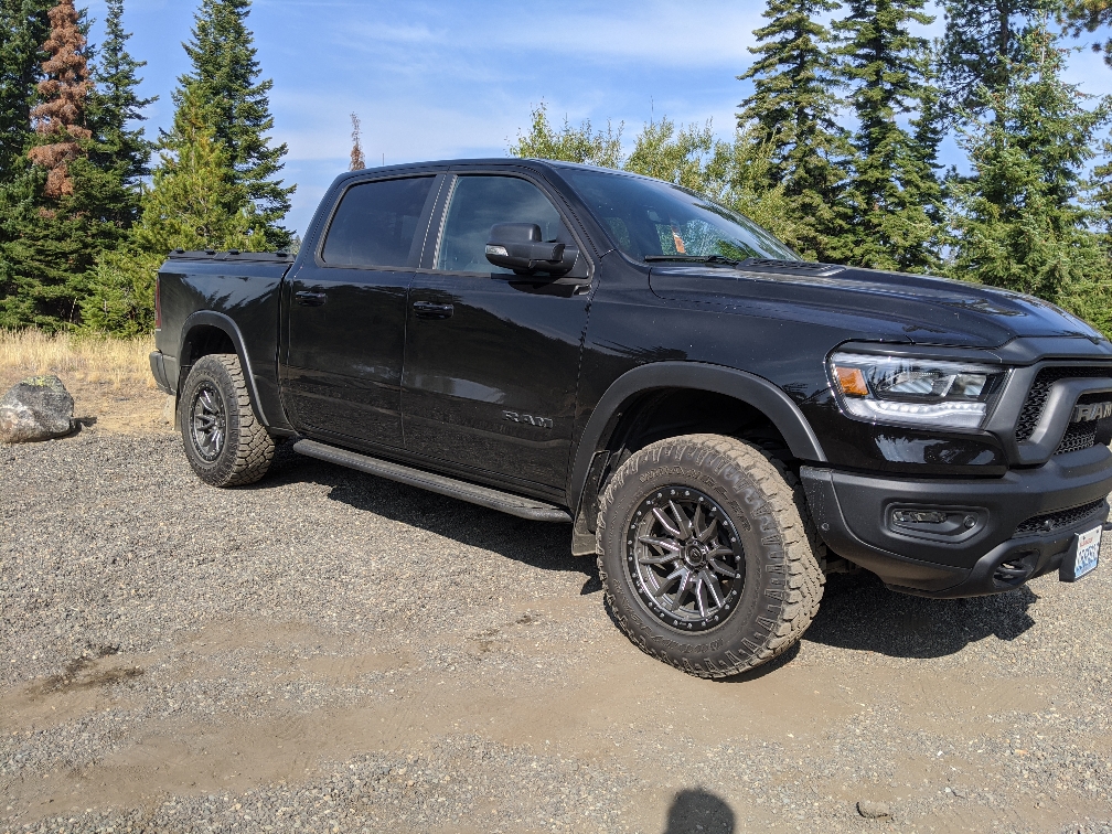

Do you have a picture of your truck?As promised here is the data I collected:
Measured floor to wheel well. I also validated the measurements when I took the weights out. What was interesting is that removing the weights left me 1/8 lower than when I started. I rocked the truck and everything went back to the starting measurements. Don't know what this accomplishes, but I said I would do it haha.
Here you go.Do you have a picture of your truck?
Looks sweet, can you fit 35s with those shocks?Here you go.![]()
Currently I am running 295/75r18 (34.3x11.6) on Bilstein leveled Front and stock ORP Spring (Bilstein 6112 shocks) Rear. My wheels are fuel 12” with -18 offset. Not a whole lot of poke, but a little. The tires fit with the level and the negative offset wheel, but I feel that stock wheels would fit with no level.This is a pretty helpful thread, I'll be watching it for sure. There hasnt been much talk of raising the rear of the truck for rake purposes! And very little of payload/sag testing.
This is one of the very few.

Rambo, did you have to run any wheel spacers? Any rubbing at full lock? Got any more pics of the side? Trying to decide on 305/ 65 18s or 295/70sCurrently I am running 295/75r18 (34.3x11.6) on Bilstein leveled Front and stock ORP Spring (Bilstein 6112 shocks) Rear. My wheels are fuel 12” with -18 offset. Not a whole lot of poke, but a little. The tires fit with the level and the negative offset wheel, but I feel that stock wheels would fit with no level.
View attachment 70663View attachment 70664
Oh and are you on the 4th or 5th setting on your 5100s? Awesome truck btwCurrently I am running 295/75r18 (34.3x11.6) on Bilstein leveled Front and stock ORP Spring (Bilstein 6112 shocks) Rear. My wheels are fuel 12” with -18 offset. Not a whole lot of poke, but a little. The tires fit with the level and the negative offset wheel, but I feel that stock wheels would fit with no level.
Rambo, sorry for all the ?s, but your truck looks great...is your rear setup just the 5160s? Air ride or no? Just looks like the rear is lifted a touch and wasnt sure if your running standard 5160s with ORP or if you got air ride that has it raised up...thanks for your patience!Currently I am running 295/75r18 (34.3x11.6) on Bilstein leveled Front and stock ORP Spring (Bilstein 6112 shocks) Rear. My wheels are fuel 12” with -18 offset. Not a whole lot of poke, but a little. The tires fit with the level and the negative offset wheel, but I feel that stock wheels would fit with no level.
You happen to have the rear orp coil part# ?. I want to add 1” rear lift my 19 ram longhorn non orp since I added 2.5 leveling kit but seems nose high. Thanks.Currently I am running 295/75r18 (34.3x11.6) on Bilstein leveled Front and stock ORP Spring (Bilstein 6112 shocks) Rear. My wheels are fuel 12” with -18 offset. Not a whole lot of poke, but a little. The tires fit with the level and the negative offset wheel, but I feel that stock wheels would fit with no level.
Check this post, I have the ORP PNs posted.O
