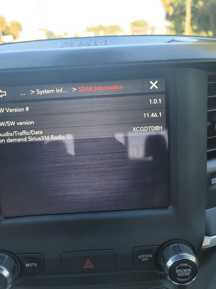

I have same issue when i get a notification sound wont come back, this is version on my radio, truck already at 2600 miles and no update promps
