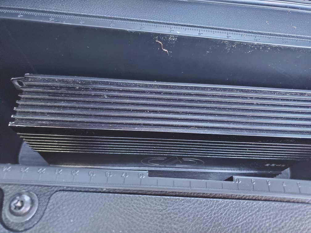

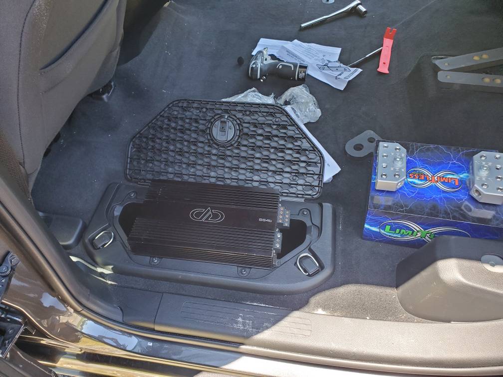

Trying to figure out amp and battery placement. Has anyone put amps in the storage pockets? I was going to run my mid/highs amps in each of them. The other will be for speakers in the bed for shows, tailgating. Do you think I'd be fine running those in the pockets? Pretty sure my sub amp will fit on the back wall and DSP where the factory sub goes.
If you do make sure you seal around the bolt because that will cause moisture to seep in if not sealed.
Not enough air, you'll have thermal issues. I've always thought that would be a good spot to get creative and make a speaker or possible sub with the right engineering out of them.

Dis you ever find a spot for it? Were you able to finish this?
I'm on the road for 10 days. When I get back, I pretty much decided to do the amp rack across the back with a standoff to clear the 2 vents. Possibly cut 2 holes for them and carpet over it for more ventilation.
I've got to put everything in with the seats raised and measure. I am running several 1/0 runs to a 370 amp alt to my lithium battery.
I'll be running a DSP, 2 4 channel amps and 1 sub amp.
