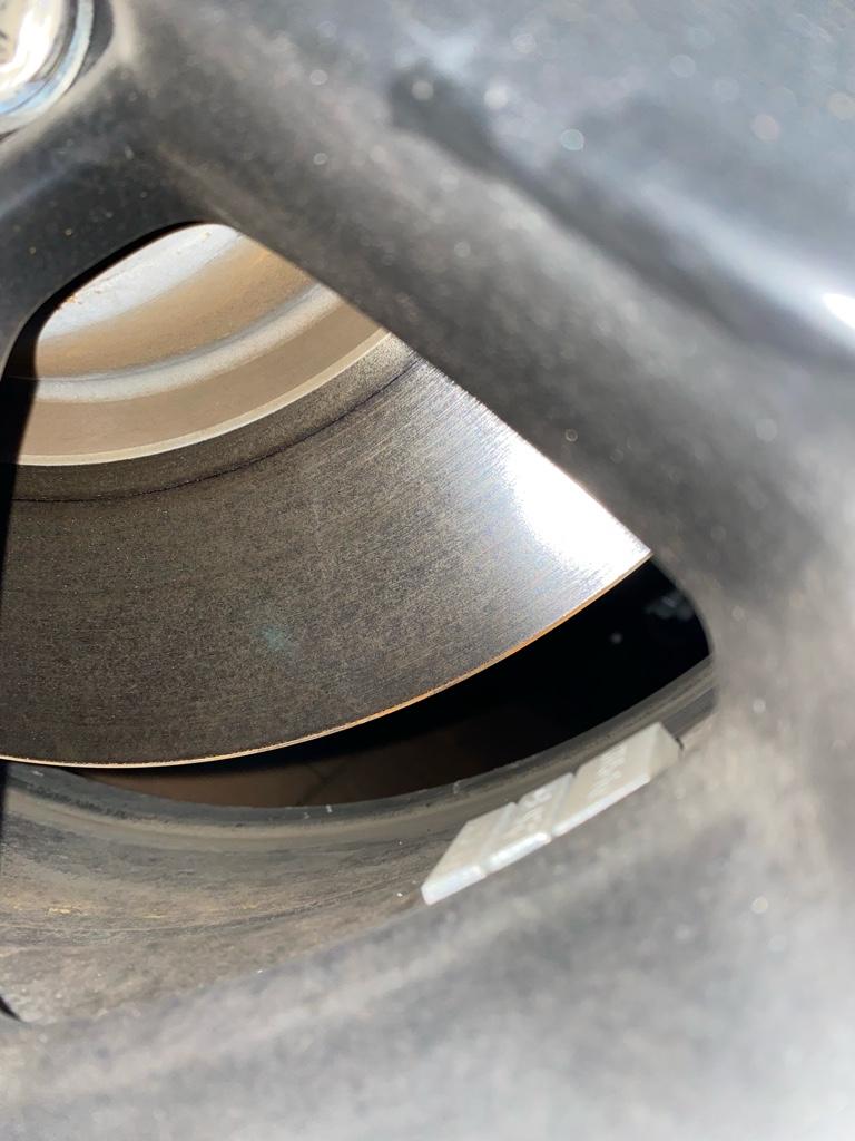

NorthernArea51
Jul 30, 2020
660
500
NY
Check out the rotors best I could when I got home from work. Driver side front rotor looks like this...couldn’t see great but it almost felt like it was a crack
FastBlackRam
Aug 26, 2019
340
170
This is what my front rotor looks like. Yours definitely has a crack in it.
