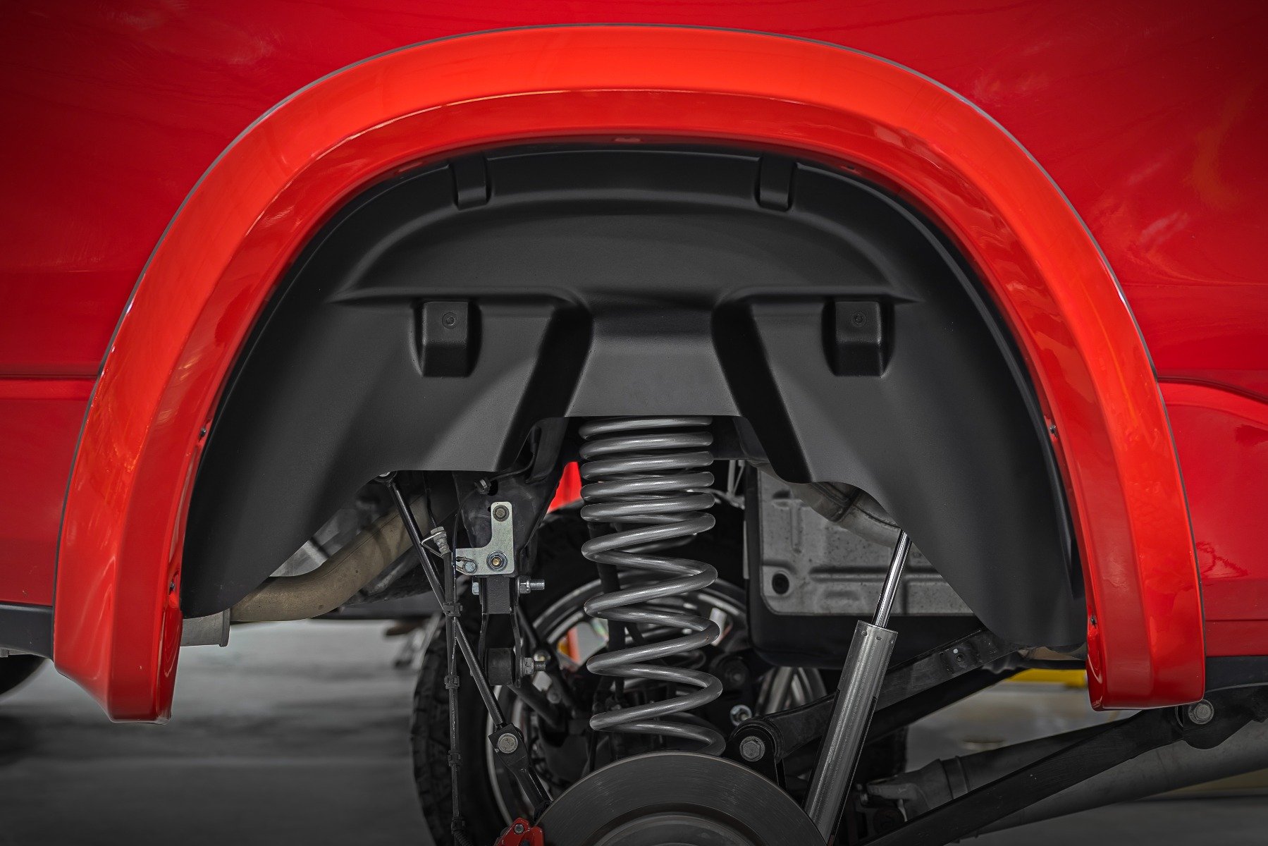

Well after a few months I decided to install some wheel well liners myself. Ordered from Rough Country. These went over the 1/2 liners already installed. Pretty simple process. Instructions were simple to follow and nothing extra besides a blow dryer to loosen the plastic to fit perfectly was needed.715C0B2D-8C81-46DD-989E-792B5AFB3B17.jpeg

Well after a few months I decided to install some wheel well liners myself. Ordered from Rough Country. These went over the 1/2 liners already installed. Pretty simple process. Instructions were simple to follow and nothing extra besides a blow dryer to loosen the plastic to fit perfectly was needed.View attachment 76486
I'm getting ready to install mine. No holes along the outside? Looks like they just pinch in between the original half liners and the metal frame, right? Leave the half-liners on the truck, but they'll be hidden behind the new liners?
Yes they go over the existing half liners. Just loosen the screws that are currently there. Remove the one screw from the rear liner completely. Once that’s done you can go ahead and insert the liner. Put the push pin in and align the rear hole in the liner with the hole in the existing liner and reinsert the screw you removed.
I found it easier to put the new liner in from the bottom and set it on top of the metal flange. You may need to use some heat, to loosen the plastic along the mid/upper portion of the liner to get it in the entire way. I just used a blow dryer.

Just call RC. They’ll send them free. It’s one push pin per side. Usually taped on the liners.

I'm pretty sure RC liners will not work for Ramboxes - there is less space in the wheel well then in a regular cab. So OEM Mopar wheel liners is your only option.
