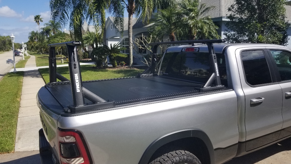

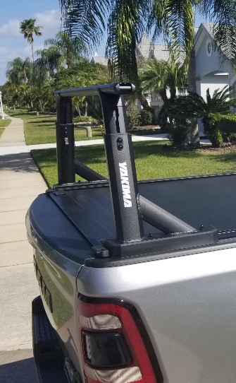

Yakima HD Tower mounted Retrax Pro track. Use it for carrying my yak. Nice rack. Very sturdy. Solid enough for rack mounted fold out tent options and side bars/packs ir you really want to go crazy.
@ rebelmike, is yours a universal kit or Ram specific, i really like it?
The only part that was particular to my truck was the retrax cover compatible track mount. I can slide and reposition the the towers in the tracks, but so far have just left them where they are. Works great and locks in place.
Two questions; is the bar over the tail lights supposed to be switched around? The diagonal support is pointing towards your rear wheels, wouldn't it be the same direction as the front bar, pointing towards your hitch instead?
Second question; what is the likelihood of mounting a 12 foot kayak on top of that, without it hitting a travel trailer you may be pulling?
